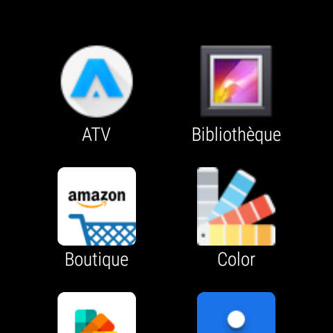

Perhaps I’m too old for such tiny icons…
If I had so many apps and especially so many favorites apps I would definitely use my ATV launcher :
I didn’t know this was such a big deal. I’ve checked the code, i’ve installed eBay and the solution is simple.
The eBay app label starts with a lowercase while the others are uppercases… That means it will come last after all the uppercase apps. I’ve modified the code to sort every app with lowercases. It now appears correctly sorted.

Thanks so much Eric! I knew I wasn’t crazy… The three apps that wouldn’t behave were eBay, myQ, and gDMSS Plus (as you can see) all began with a lower case letter lol. I should have caught it. I appreciate all the time you put into the app. Check your PayPal soon :big_smile:
Thanks @Tiggo, that’s appreciated.
