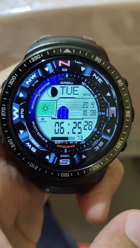

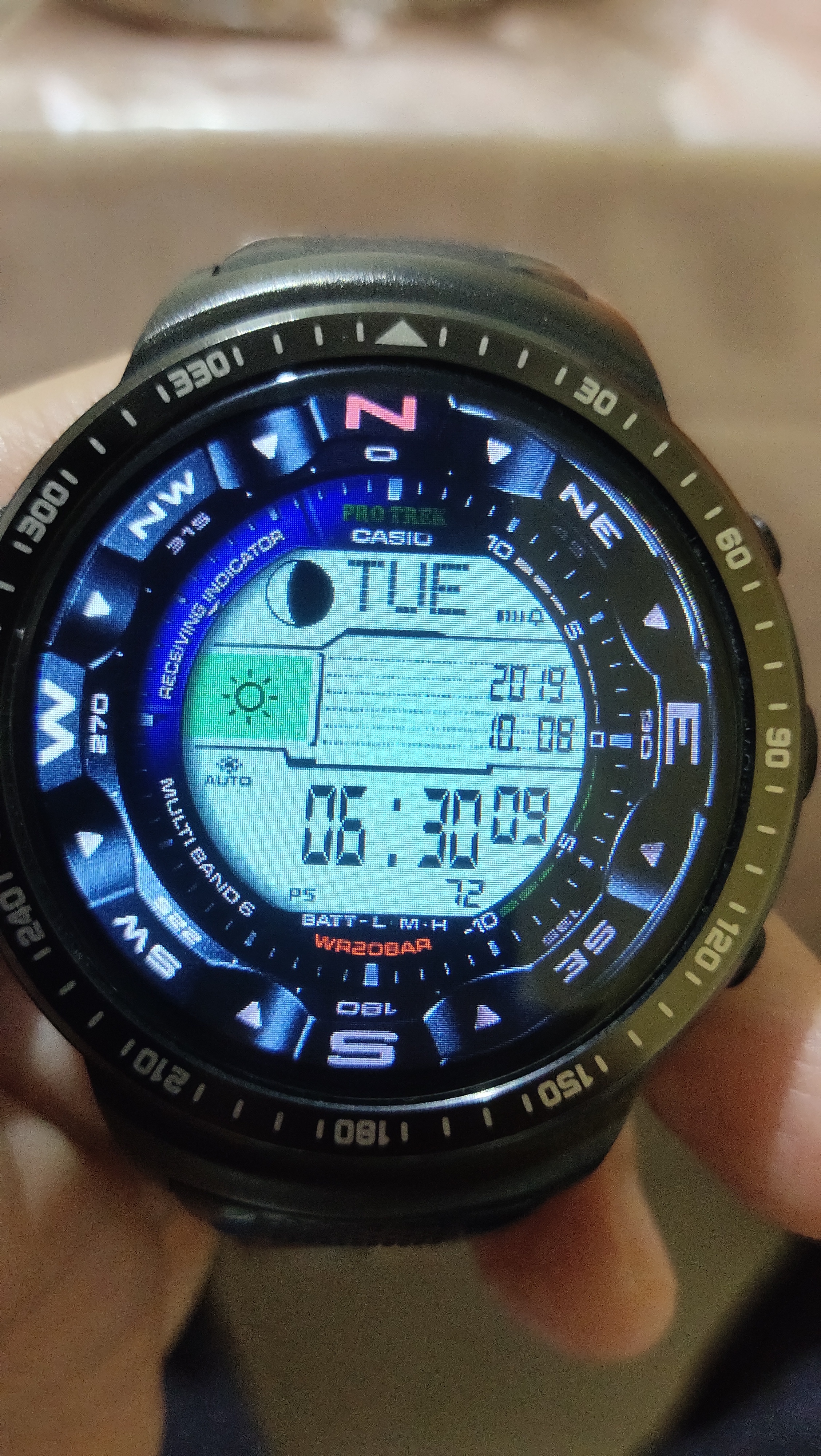

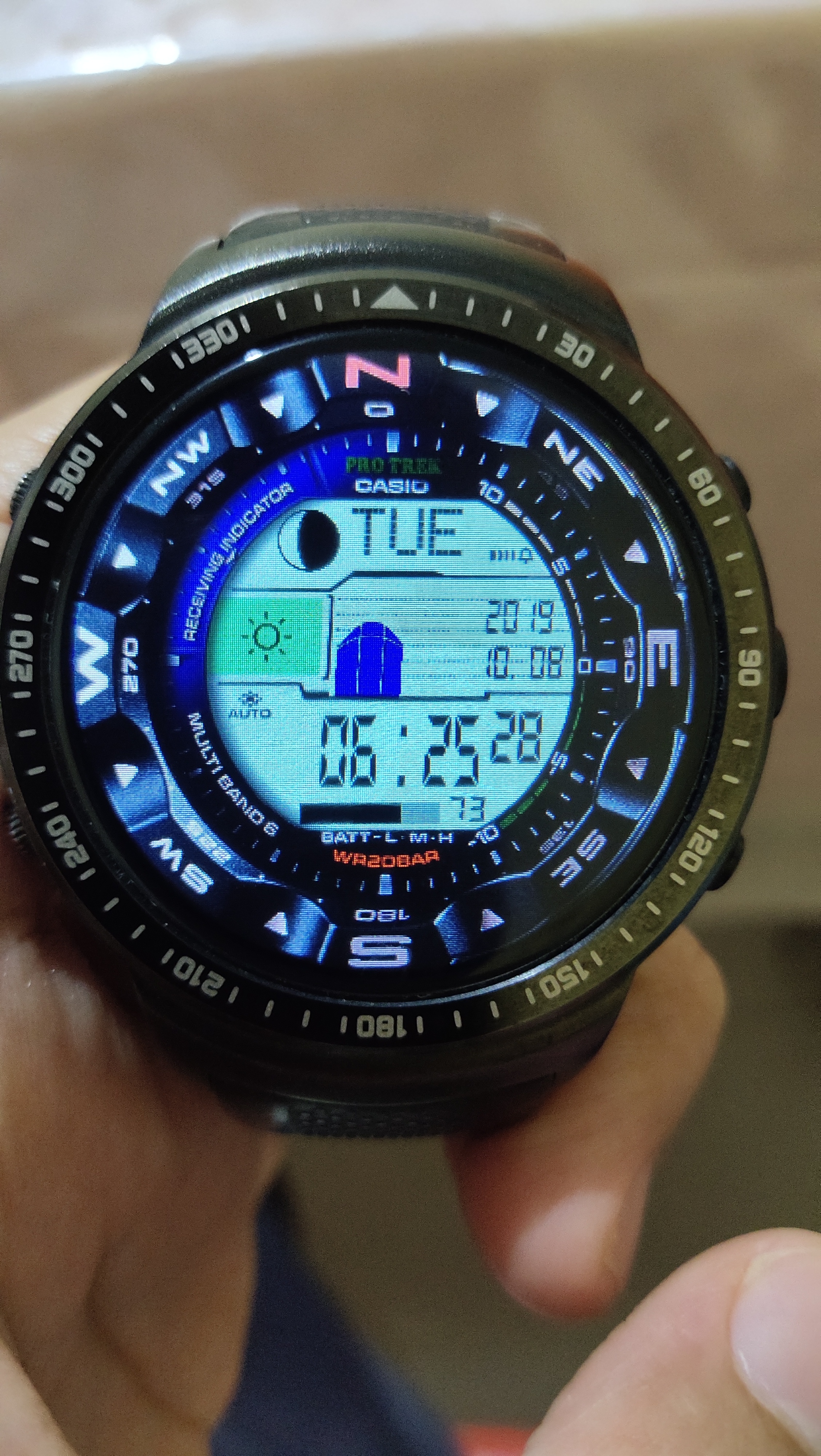

Hi @Eric_Crochemore, i’ve been working on a protrek watchface by using watchmaker app. As a battery indicator, i use a black bar then I make a progress shader with 90 degree angle. After I send it to my watch, and use the watchface, the battery indicator bar didn’t progress into the direction angle that i’ve been set, i goes to 45 degree angle. Any idea why is that happening?
Not trying to butt in here, have you tried exporting as a “tweaked clockskin” and checking the “create extra layer box”? Just throwing it out there. Maybe it will work, Good luck.
You should share a link to your skin and I will look.
Aah yes, sorry
here it is https://www.dropbox.com/s/rawhe4uehimuczv/protrek-prg-250.watch?dl=0
Well, you’ll never guess what it is !!
The shader should use radiant numbers, and i give degree numbers… You’re the first one to notice that !!
Probably all other shaders have the same issue.
@Eric_Crochemore Is this why my Kerbedanz Sagittarius tourbillon logic didn’t work? I think you said something about it
So…i think I should wait for the next version of UL then?
