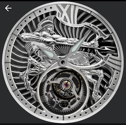

@Eric_Crochemore hey there, the latest version of ulauncher completely broke the tourbillon logics on a watch I created. Do you have a link to the previous version?

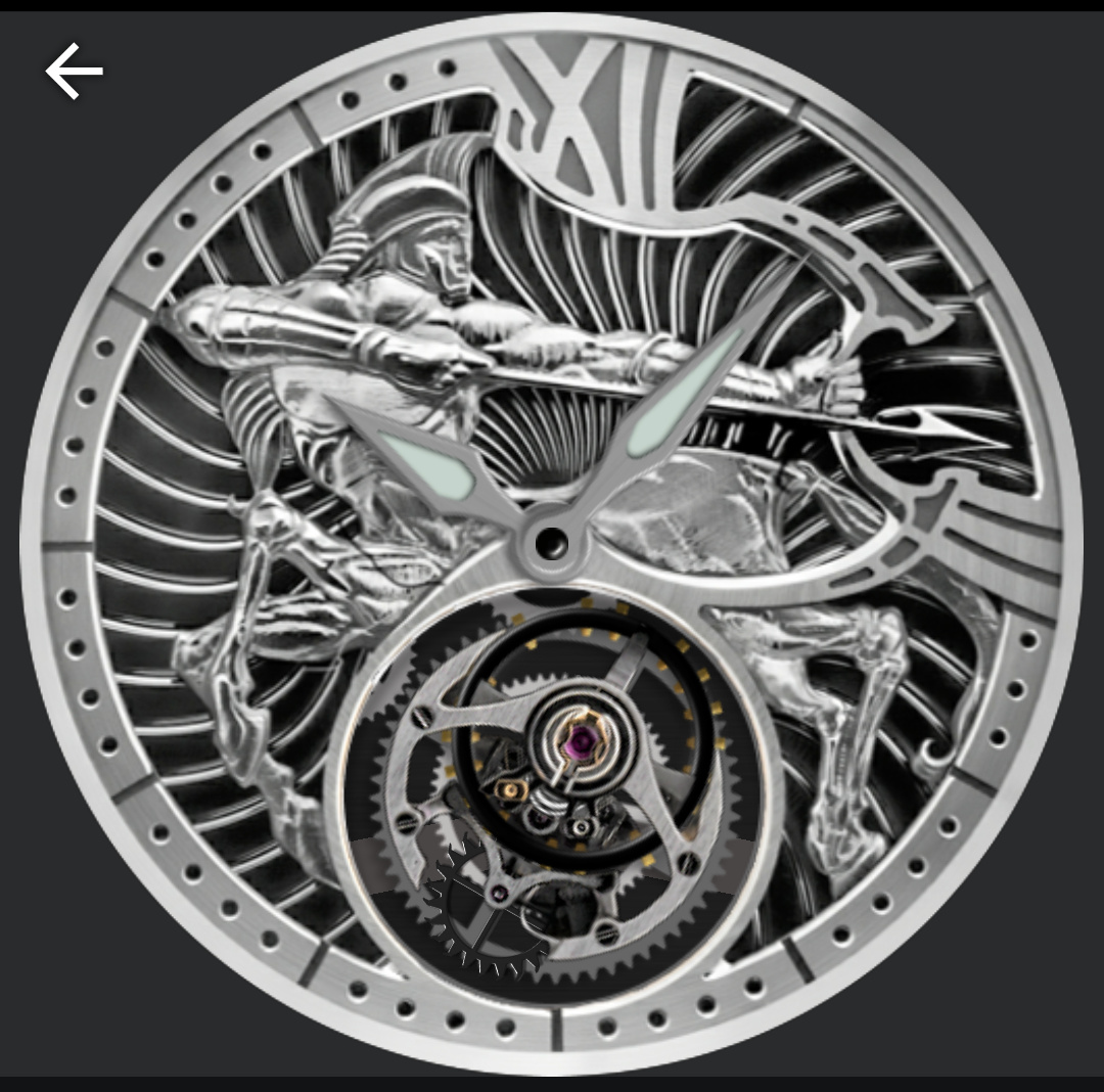

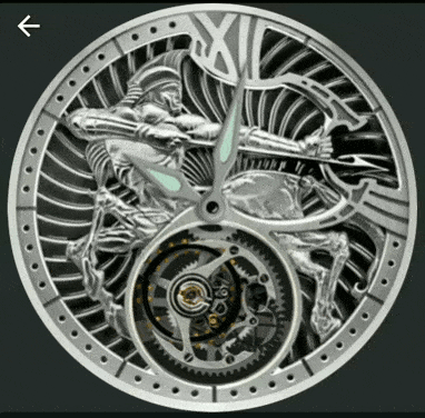

you can see here in the gif some of the animation taking place on the previous version of ulauncher;
the black ring should spin to each side a bit then reverse but the rotation is no longer working:
math.abs((math.floor({dss}/500)*500)-(math.mod({dss},500)))/1.7-140
Spring no longer contracting and expanding (change in height) with every second:
math.abs((math.floor({dss}/500)*500)-(math.mod({dss},500)))/17+100

I found the problem. The new version of UL is based on a new version of the Cocos2dx release. This new version has aligned the lua langage to a new release too⦠In short, the āmodā function has been deprecated, replaced by fmod. So adding a mapping from mod to fmod and everything works again.
I will try to see what other deprecated function have been removed and then publish the update.
Thanks for your patience and @G1NT0N1C for his help ! ![]()
Edit: Lua version is the same (so i was wrong, thereās not really an update), but this deprecated method is not activated in this version⦠iām still searchingā¦
We are lucky to have you xD well done, and I hope you remember to enjoy your vacation too
