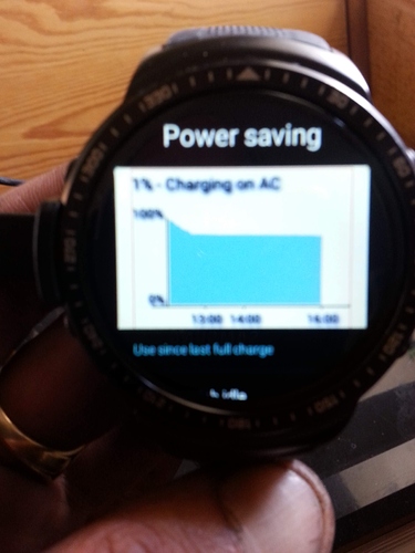

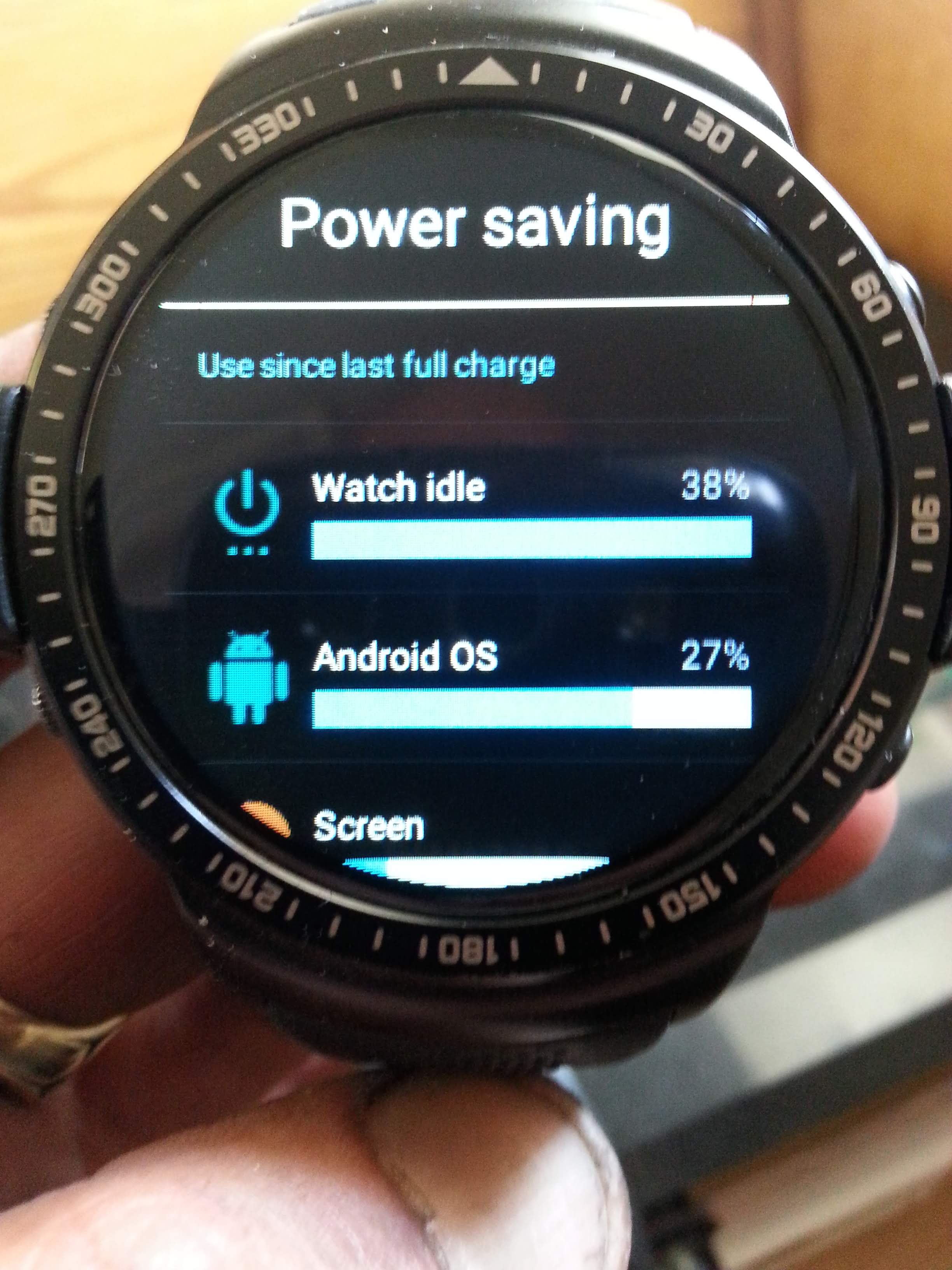

The battery in my 2 week old Thor Pro has started behaving badly
It runs as expected down to around 80% then switches off without warning due to discharged battery and is at 1% when switched back on.
Nothing in particular is draining battery life see attached pics.
For the first two weeks it ran fine, it appeared to do an OTA update recently as I had the “starting apps” messages on boot.
I have already factory reset yesterday and the issue is persisting. Anyone know what I can do or have I received a faulty one?
Thanks!

reset again the watch and charge it till it reaches 100%
I started having issues with the battery after an OTA update so I’ve now flashed the X300 firmware version from this forum and I’m trying different combinations of hard resets, full charges, full drains and partial charges.
It seems that android isn’t reporting the battery life correctly: e.g it may stay at a reported 50% for 2 hours whilst switched on with a sim card installed, wi-fi OR 3g data and gesture-wake active (in reality the battery must be draining somewhat) then dies while showing 50% and says 1% battery when switched back on.
I’m getting approx 4-6 hours battery life in the above configuration which leads me to think the battery is ok and it’s a software issue but it’s inconvenient and annoying having no working battery meter leaving me to guess how much power is left as I go through the day.
Aug 1, 2018 19:24:12 GMT 1 Sam Brook said:
getting only 4hrs to 6hrs is not normal, plz reset the watch again and do'nt install nothing and make sure updates and sync are off, see how battery behave.btw, 3g can have great impact on battery life if there is'nt coverage in the earas you in.
