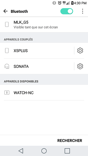

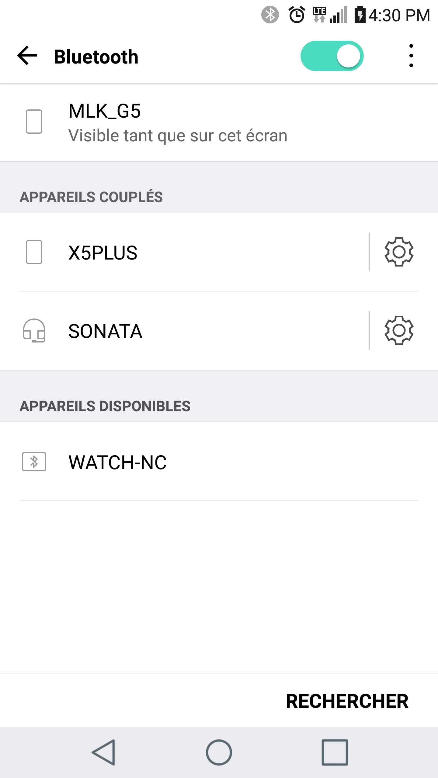

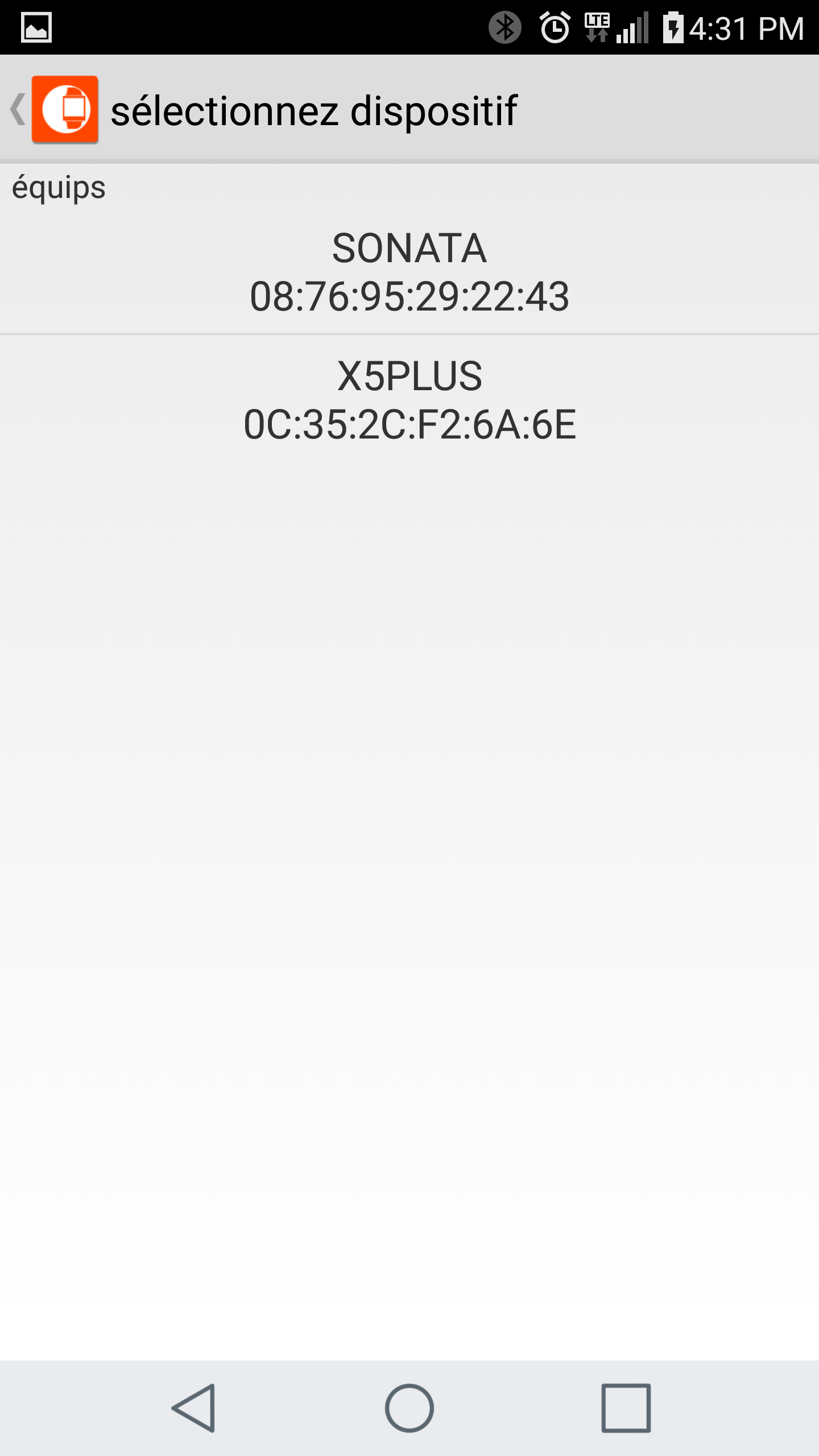

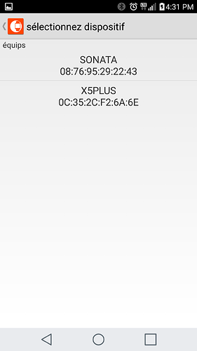

in bluetooth how does the phone see the watch? do you see it twice or just once? if you can upload images that would be great because it should'nt be any issues with tethering.
Mar 13, 2017 20:58:00 GMT 1 soniasophie9697 said:
Mar 13, 2017 19:27:21 GMT 1 oglaolga said:
Yes Sonia, I did the ‘Reset device’ in Settings menu.
Always, after the successful pairing, Watch helper (on my smartphone) see the watch in the divices list, I tap on it, it try to connect and fail.

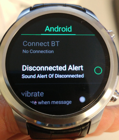

- Smartphone Bluetooth menu - WatchHelper menu - WatchHelper menue on watch

Mar 13, 2017 21:52:09 GMT 1 oglaolga said:
ok, the watch and phone are paired, try using m2d and see if the problem continue and then will see what can be done.
