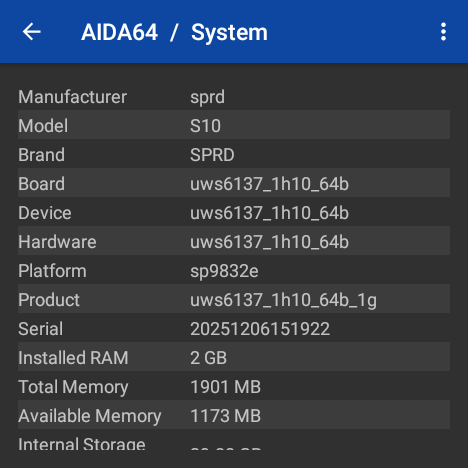

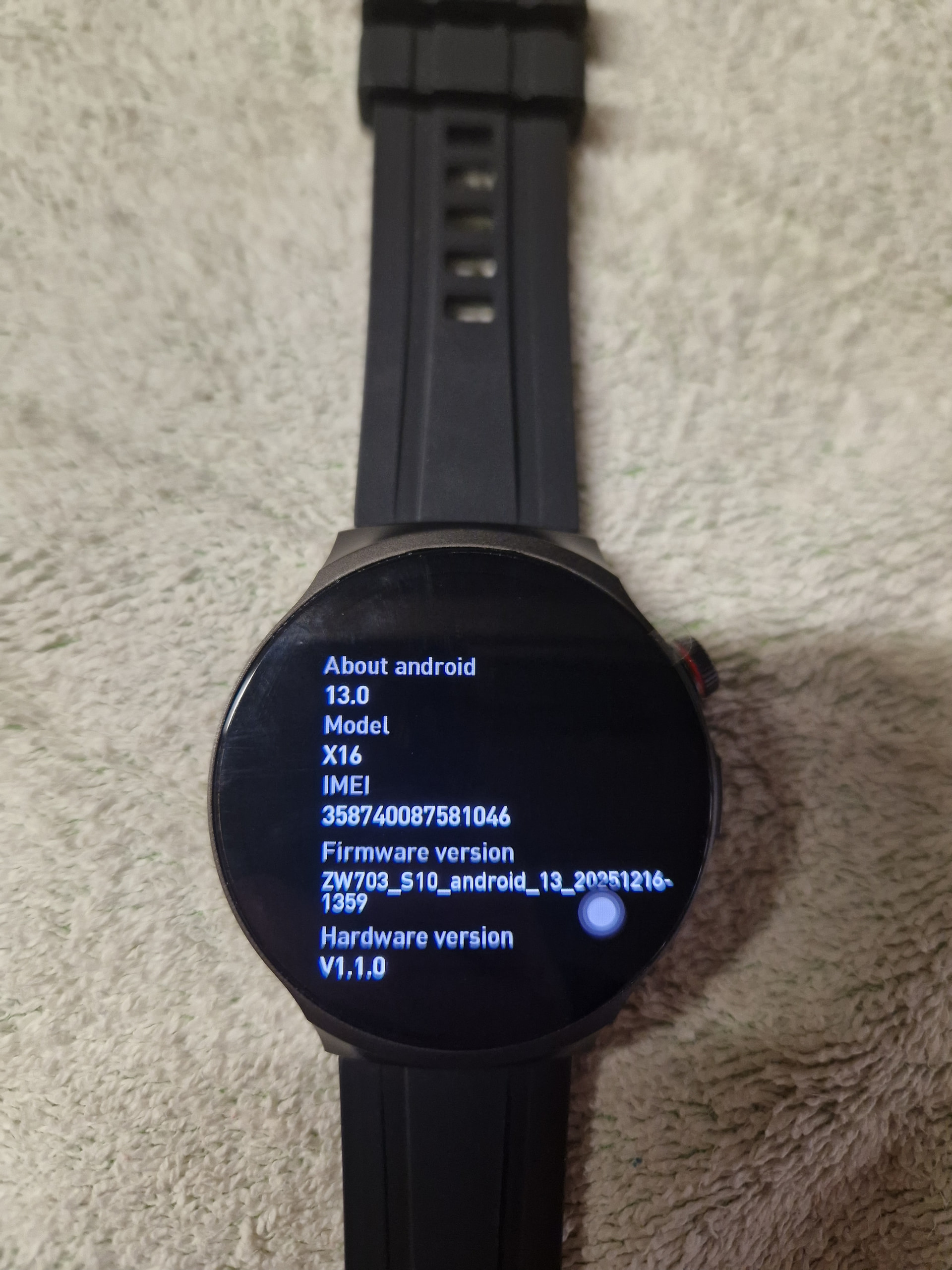

SIM card not being detected, no back camera, ZW703_S10?

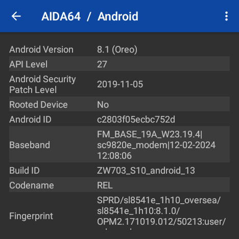

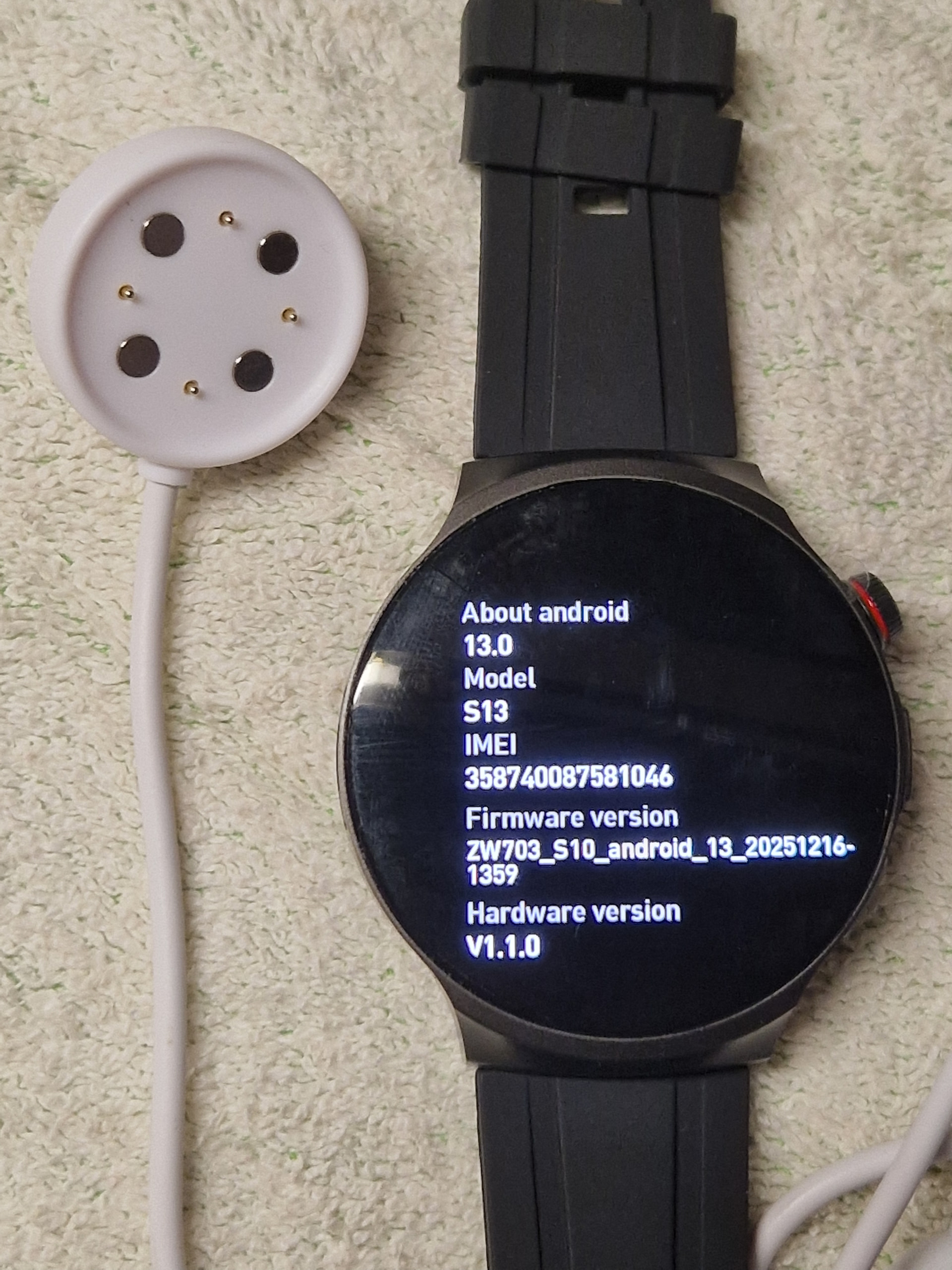

after a factory reset, when opening “About watch” for the first time it says X16, and if I close it or let the screen turn off, it will say S13 again.

This is a fake, i suggest you to return it to the seller.
At least not a S13 watch. For sure.

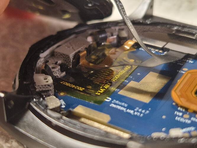

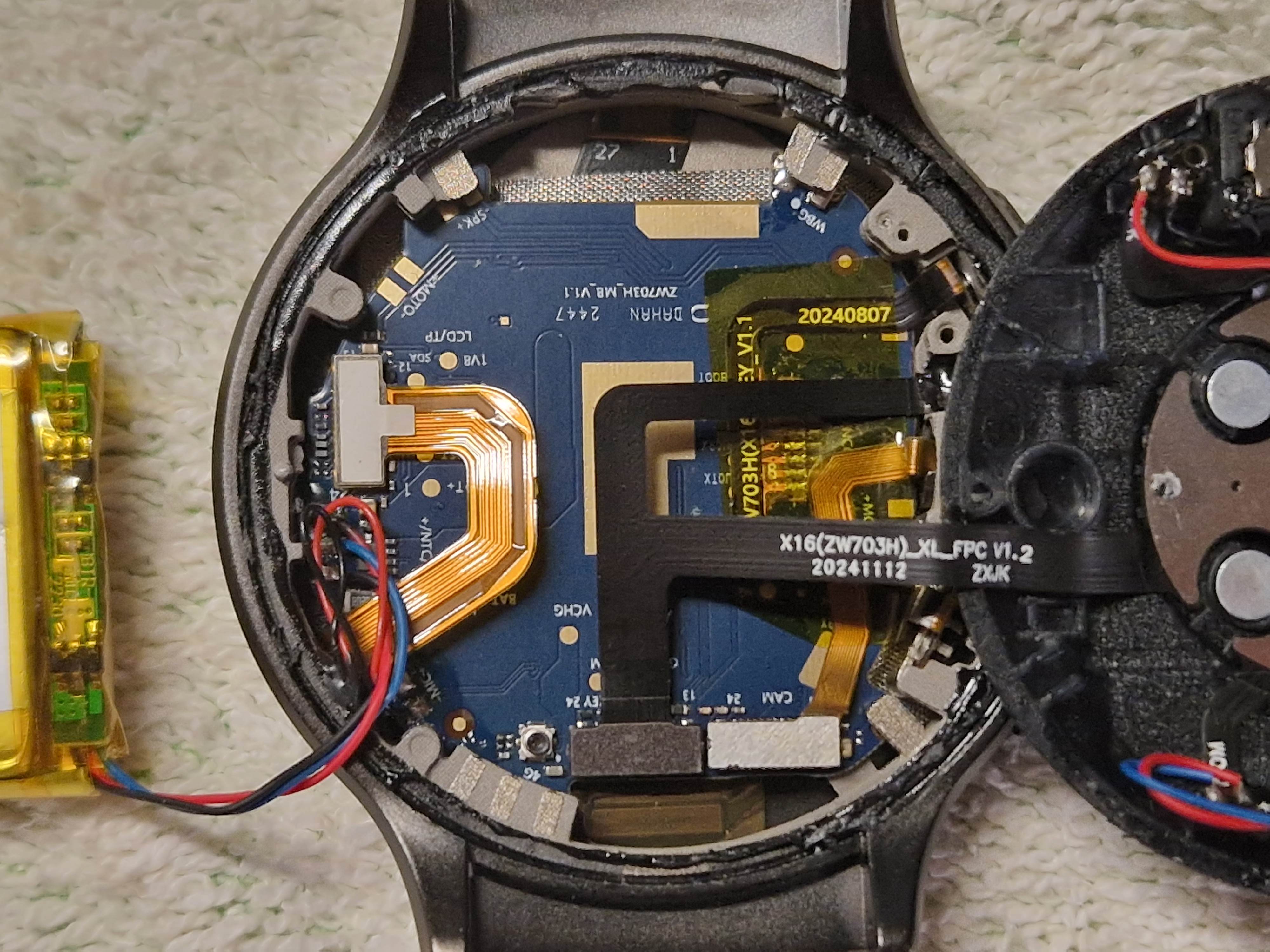

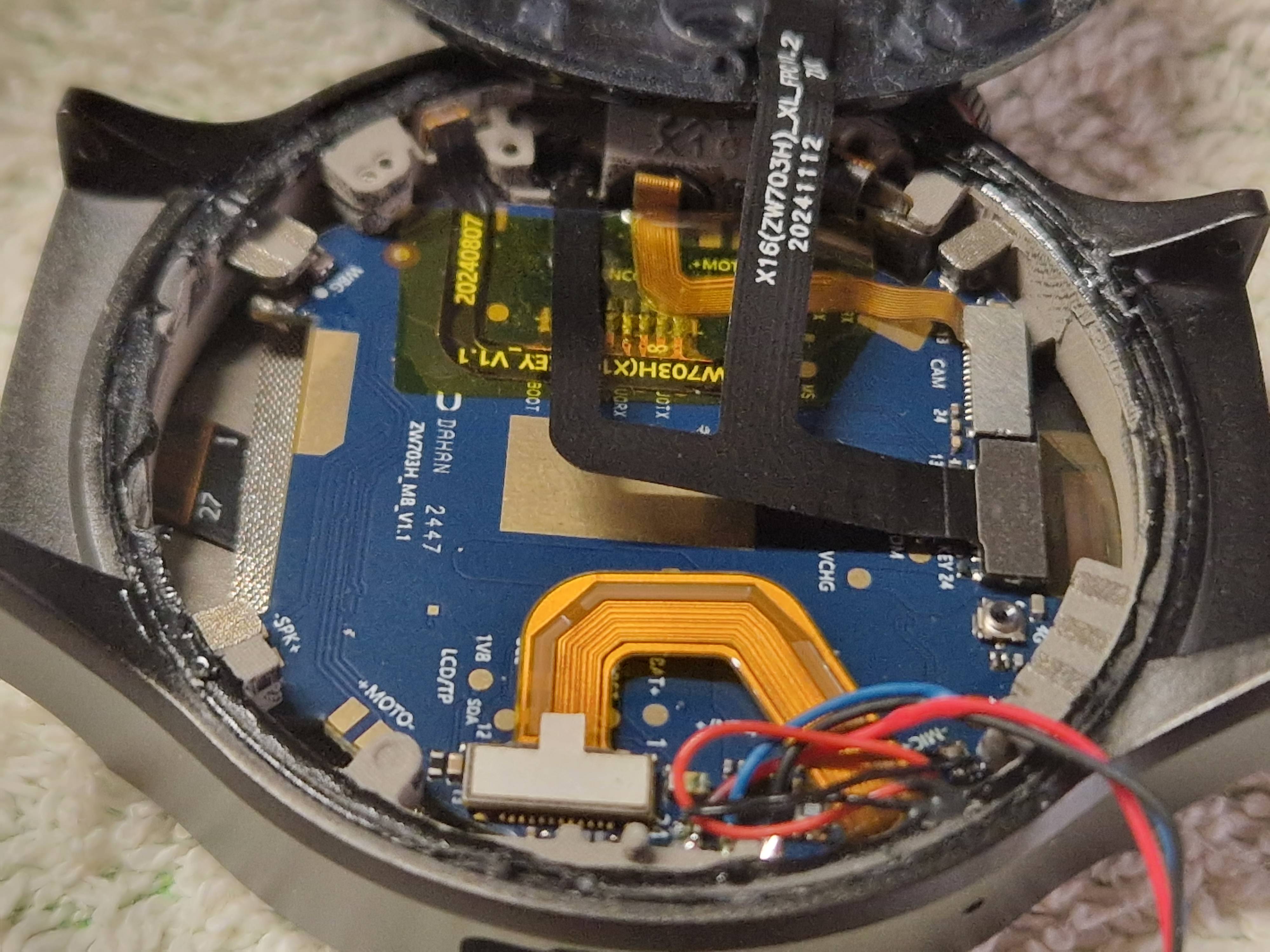

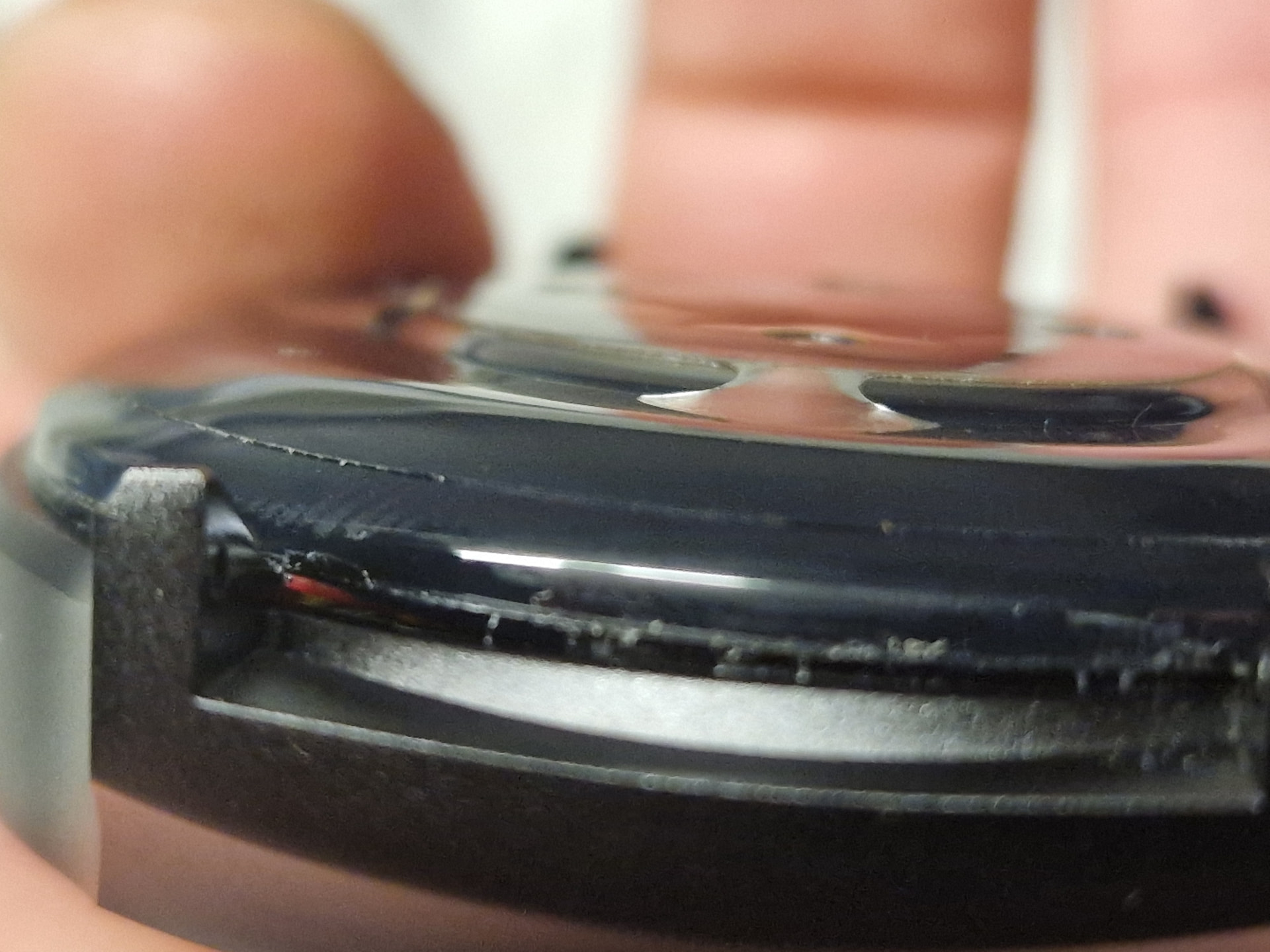

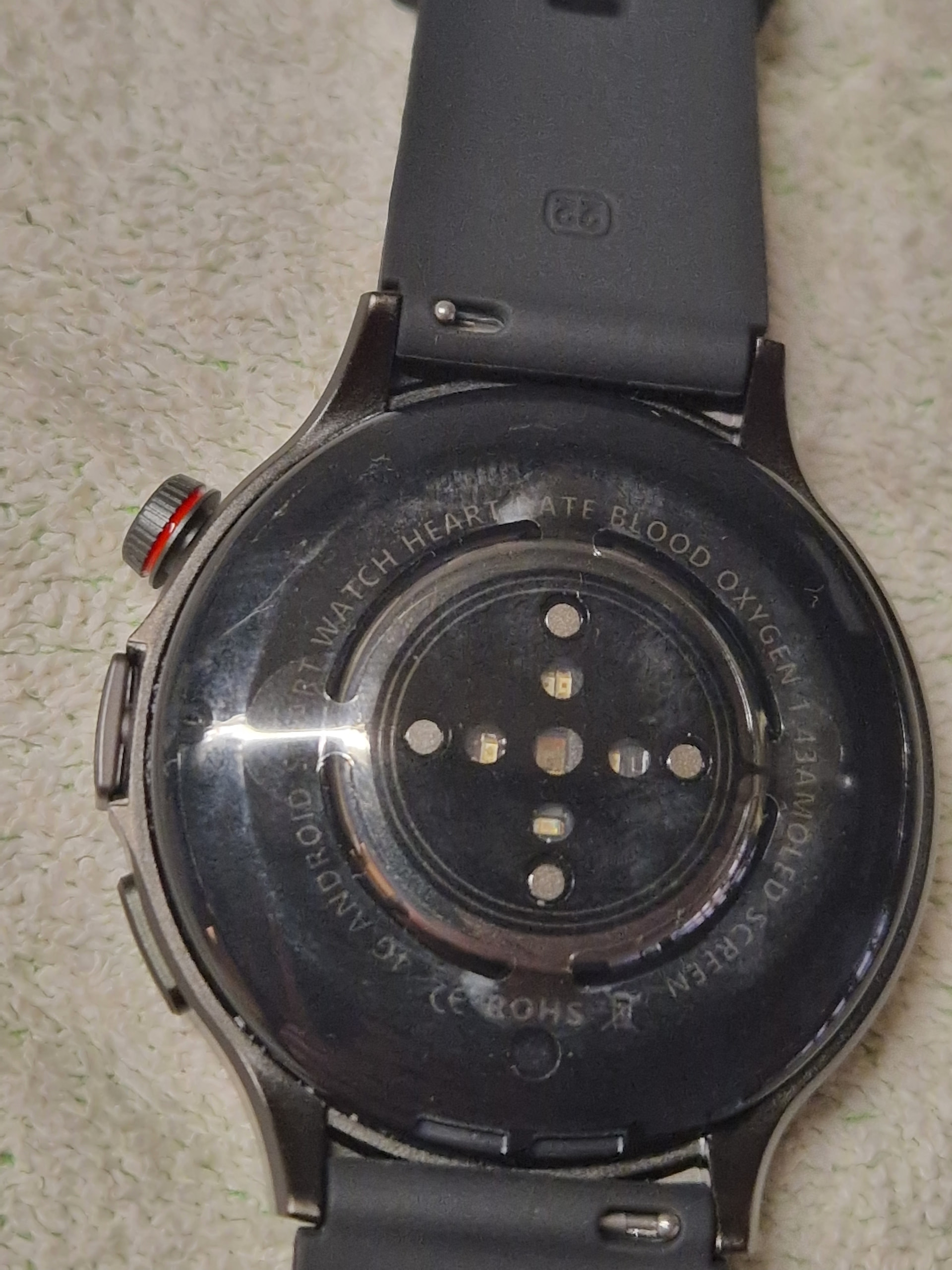

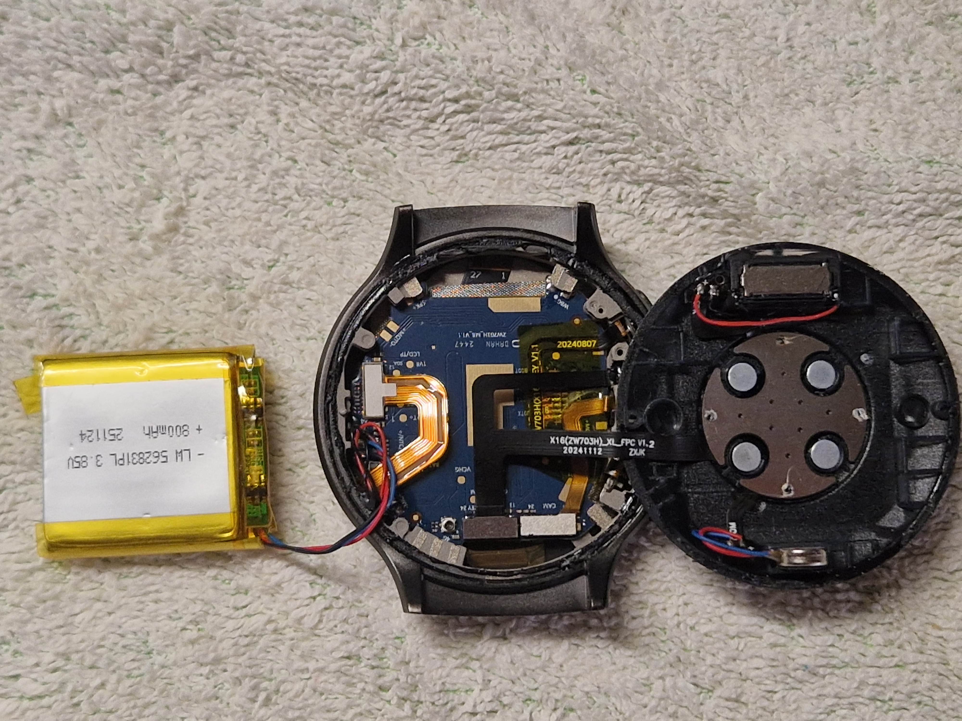

the back of the watch was glued by a 7 year old child, I was able to pry it off with my fingernails

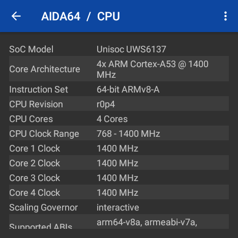

Yep, it’s a Unisoc device according to the pdf you shared. Definitely a pile of trash if they didn’t even bother screwing the rear cover on. It looks like a used one that was returned and made to work again and then sold. But yes, definitely not ASR S13.

Aida 64, device info hw etc have no use in these device, they also get tricked, use my developer helper or use this https://epcdiy.org/

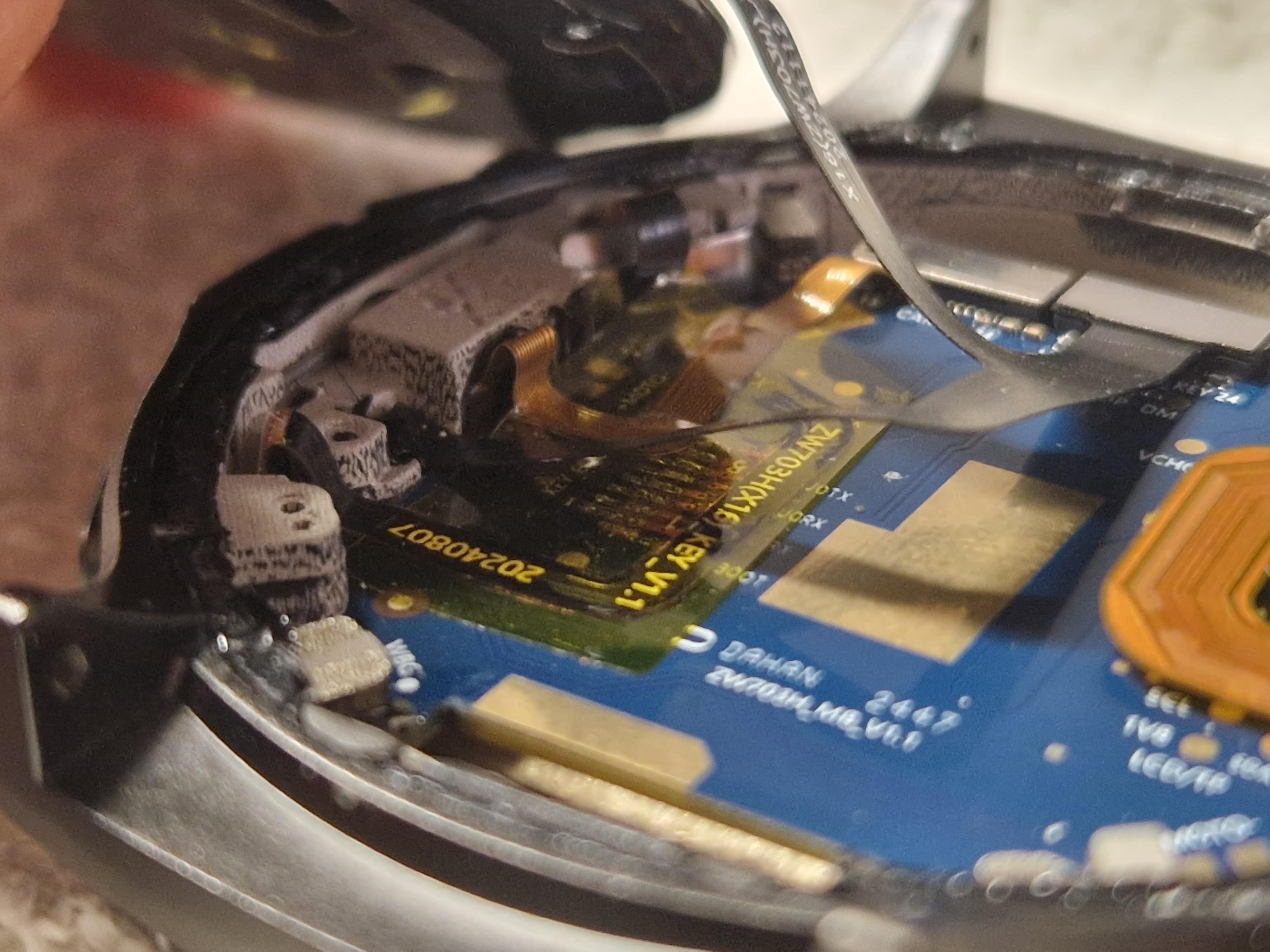

HW info will work, but still shows incorrect fake ram and storage details. Apart from that, it works on the S13. Looking at the pics of the board, I can see already that it’s not an S13 anyway.
So, sadly they did sell him something incorrect.

the back of the watch was almost coming off when I received it, I could see the battery wires even before I opened it. I am definitely returning this junk, I opened a dispute as soon as I received it.
