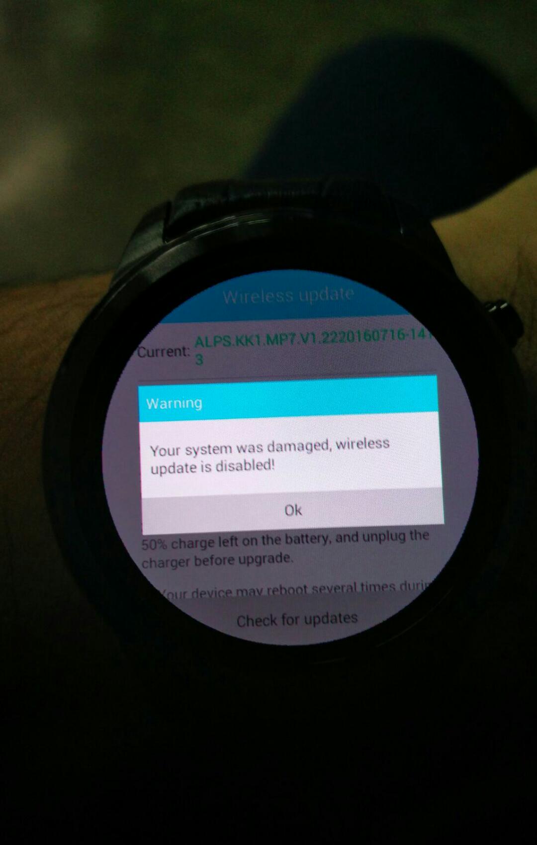

As some of you may know, the original X5 has had an OTA recently. After installation another appears to be available and it can be downloaded.
However, if you go to install this second OTA it will end up with an error saying that your system is corrupt and OTA service will be disabled.
See photo below…
I have just been talking to Finow senior engineers about this.
For now we have agreed that the OTA service will be disabled for the original X5.
Once a solution is found I will let you know. Cheers.
