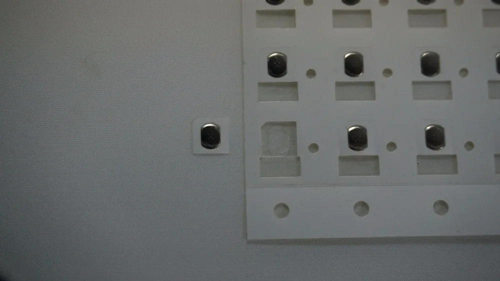

you can buy new buttons / switches here:

@noidremained Thanks for the link. I got some response from the AliExpress seller saying they will check with the manufacturer for the replacement part. We’ll see where that gets me. If nowhere, I might order the replacement switches you have linked though I’m not sure they are exactly compatible as the LEM 10 looks like one piece design for both switches and would probably have to be cut up in order to replace them:

@noidremained posted a link aboth. It should work, but you’ll need some manual skills.
