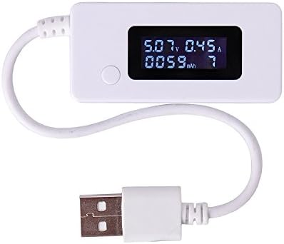

Get one of these or one like it to see what is going on…
If it reads O amps, but voltage is present, there is a connectivity issue.
The picture below shows a normally charging device…

If I connect to pc through usb cable windows makes the sound indicating a device has been connected, and the tester like that you suggested indicates 5V and 0,4 A a few seconds after the sound, then current gos to 0. How you can tell if it is a connectivity issue or a dead battery?
