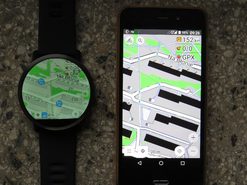

Thank you fro your time. I will make factory reset and let you know if it helped. I will also consider rooting the phone.  I’m disappointed with max brightness. I have cheap Chinese phone Gretel A7 and it’s max brightness is astounding comparing to Lem X. Like night and day. I went into inside settings by some third party app and I saw that in Lem X there is '100" value for max brightness while in A7 there is “255”. Both are MTK based watches.
Yes, that’s because this larger screen has 4 back lights.
If you step up the brightness any more then the battery will drain quickly
Of course I know that. But watching map in full sunlight for 5 seconds shouldn’t kill battery immediately. A7 has 3 times bigger screen and only 2,5 bigger battery,
Here how they compare on my window seal with max brightness:
Yep, that’s what I would expect.
pablo11 AvatarJan 8, 2019 9:36:53 GMT 1 pablo11 said:
Yep, that's what I would expect.
And I have No.1 D5+ watch with tiny battery and it's still brighter (after two years of use) than Lemfo X. I think Lemfo backlight LED diodes still have a way to go. But to check it I will have to root it.
