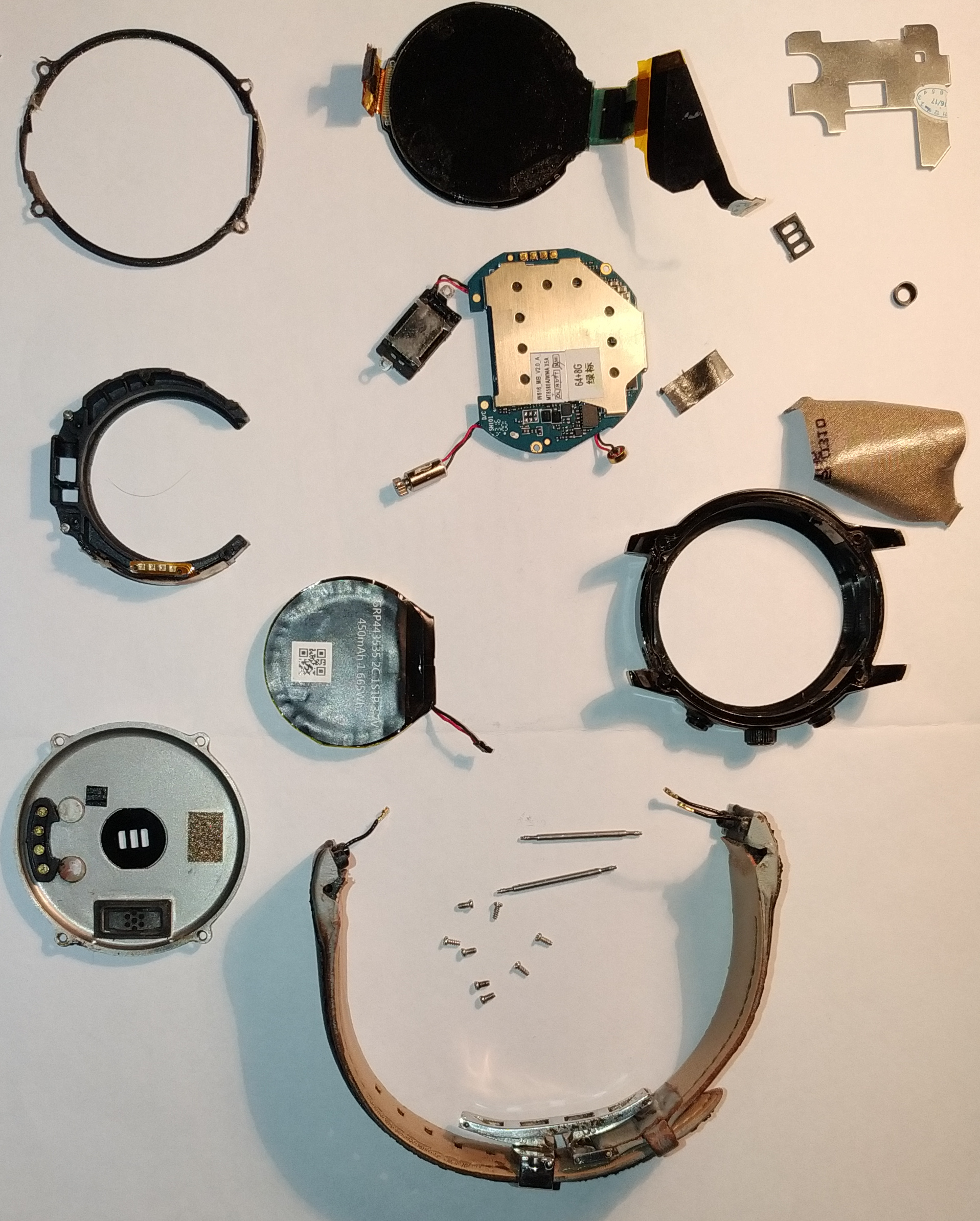

now my fino x5 plus screen watch broke how i get replacment screen for this reasons? i contacted with supplyer co. but they said i havnt replacment screen! now what i do?
You can buy a new x5 plus for round about 50$. I know, that can be a lot. Personaly, I wont take the risk and try to change the screen for that money.
the watch can be disassemble
https://4pda.ru/forum/index.php?s=&showtopic=787623&view=findpost&p=91820317
Of course. The question is: can it be reassembled? I mean assemble it so that it works without restrictions afterwards. My experience is that very few users are able to do this. I also accidentally destroyed watches. Even though I am very experienced.
I’ve “only” destroyed half of my watches this way :rofl:
This is a damn good rate! You are a pro!:wink:
