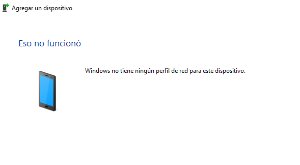

I installed mtk drivers following this video and when I do a search for connected device I get this
full_w618_wgl
But when I say next I get the message: windows does not have any network profile for this device
