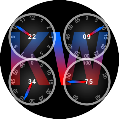

KW88 users, I need your help testing a theory on the firmware's ClockSkin Engine.
KW88 users, I need your help testing a theory on the firmware’s ClockSkin Engine. I’d like to ask you if you could try this watch face on the default launcher (not Eric’s Universal Launcher!) and tell me if the watch hands rotate correctly. If so, I’ll implement a tweak on WatchFace Designer to better support your watches.

@Davy_Decoene well, that’s one theory down the drain. Could you post a short vídeo of the watchface so I can see the erratic movement? Thanks.

@Davy_Decoene Ok, the good news is that the power handle seems to be working fine… The bad news is that the rest isn’t. So, having these results in consideration, I’d like to ask you to try this second (and I hope, last) version…

I think there still something wrong here :confused:
Yes, the 24h hand is missing and the day hand is one day ahead. But that also gives me useful information. So, now I know that the 24h acts the same as the hours/minutes/seconds (or does not exist at all, but in that case there’s nothing I can do about it) and the day has Sunday on top instead of Monday. Both of these can be easily implemented as tweaks on WFD, so I’ll publish a new version containing these tweaks soon :slight_smile:
Thank you for your testing, it was invaluable to find out how kw88 differs from finow x5/No.1 D5.
