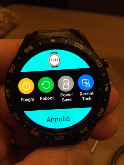

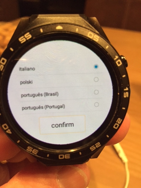

after flashing with the new firmware (KW88_20161104) the touchscreen don’t work anymore to any direction, i’m tried to reflash with factory firmaware(KW88_CS1_B_20160707) but without response,
after reboot appear just 2 screen below, but for me is impossible to change somenthing.
if somebody can help me i’m very appreciate

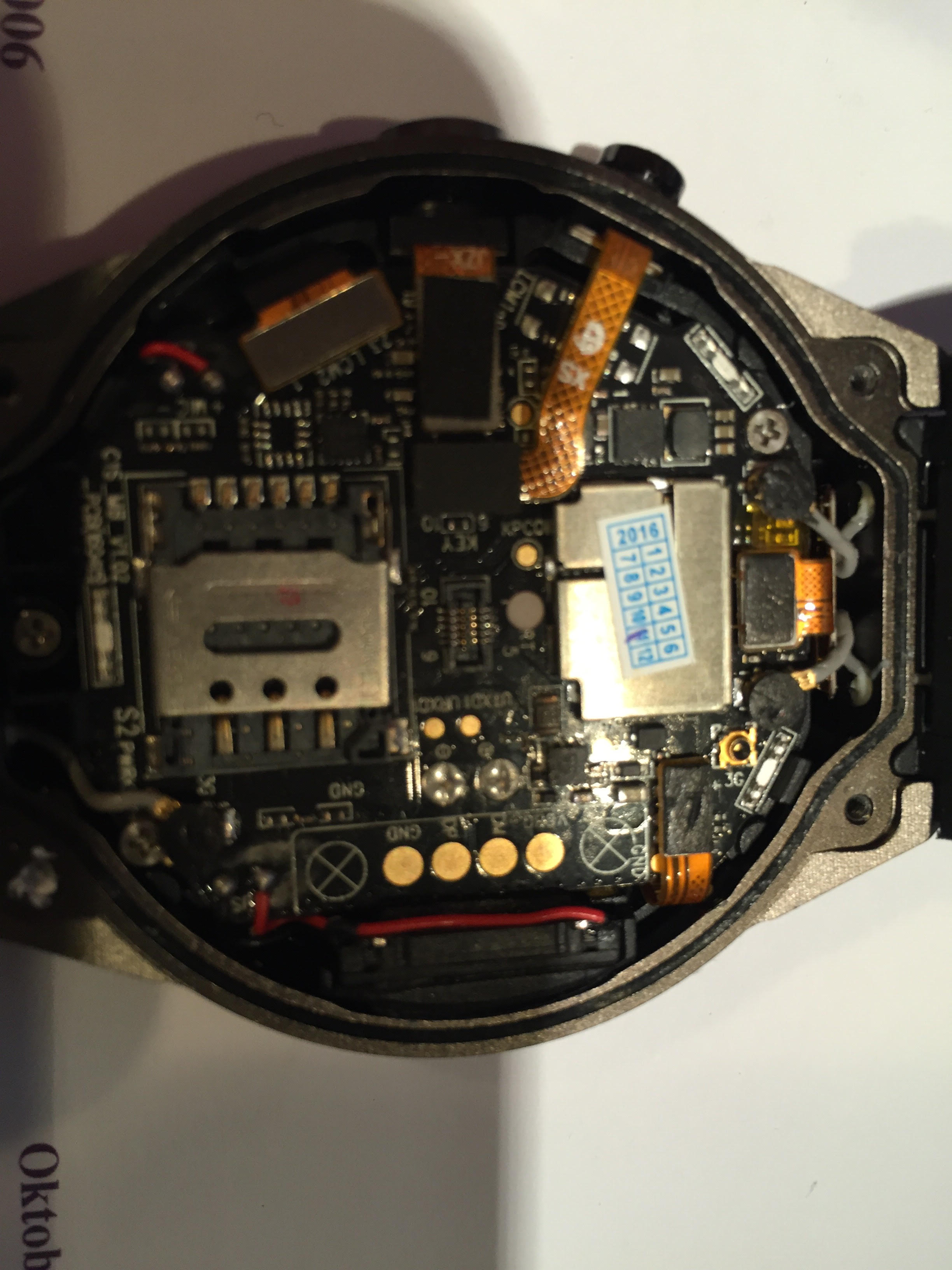

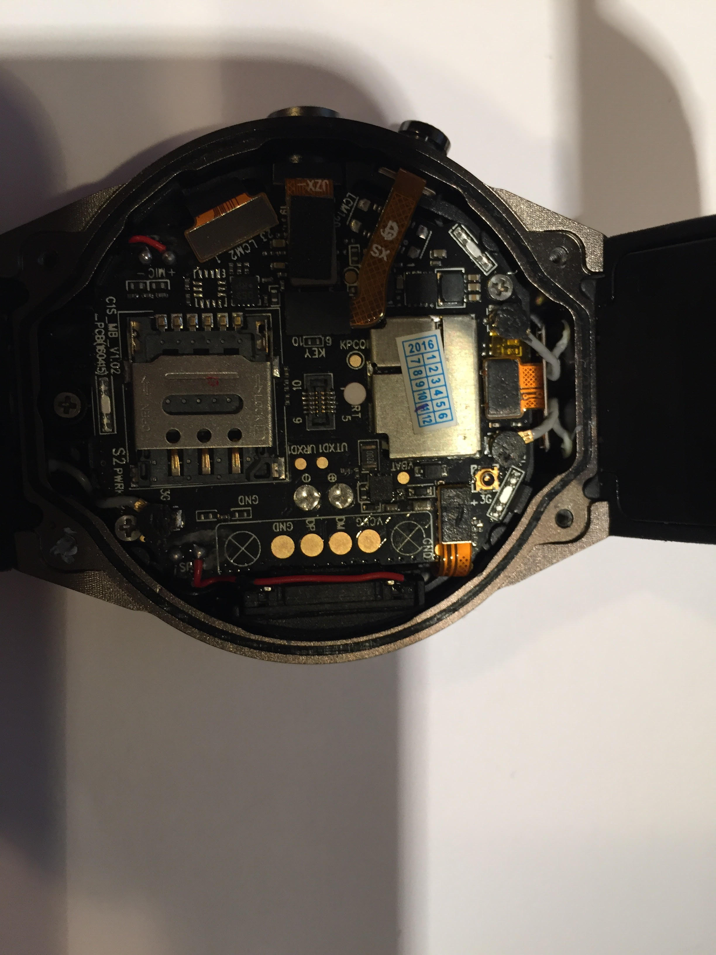

Open the back off your watch (4 screw), if i remenber there is a little connector under left, lift it up careful. after a few seconds you can reconnect.

that is just weird, what if your watch is a different model? the x3+ and D5+ and even the x5+ have two different models what if it is the same case...can you see if the model name is written inside the watch?
I can’t find…i’m make a pictures maybe can you help
