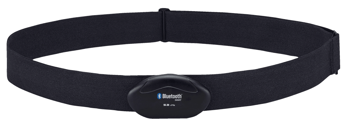

In regards to the heart rate, I use a “smart bluetooth” belt… bought it for 8 euros or so new. It lasts months on a single battery and it measures instantly and way more reliable than the built-in one. To keep BT pulsebelt connection stable, I use BT true wireless earphones with something playing.

sure. (though its a little more expensive now for some reason. 9 euros about)
Thanks a lot!
np. just remember, you need “smart bluetooth”, not ANT+… you dont pair the belt, it’s up to the app you are using to detect it in settings. (works on strava, myrunningapp, decathlon, endomondo, ghostracer and more)
