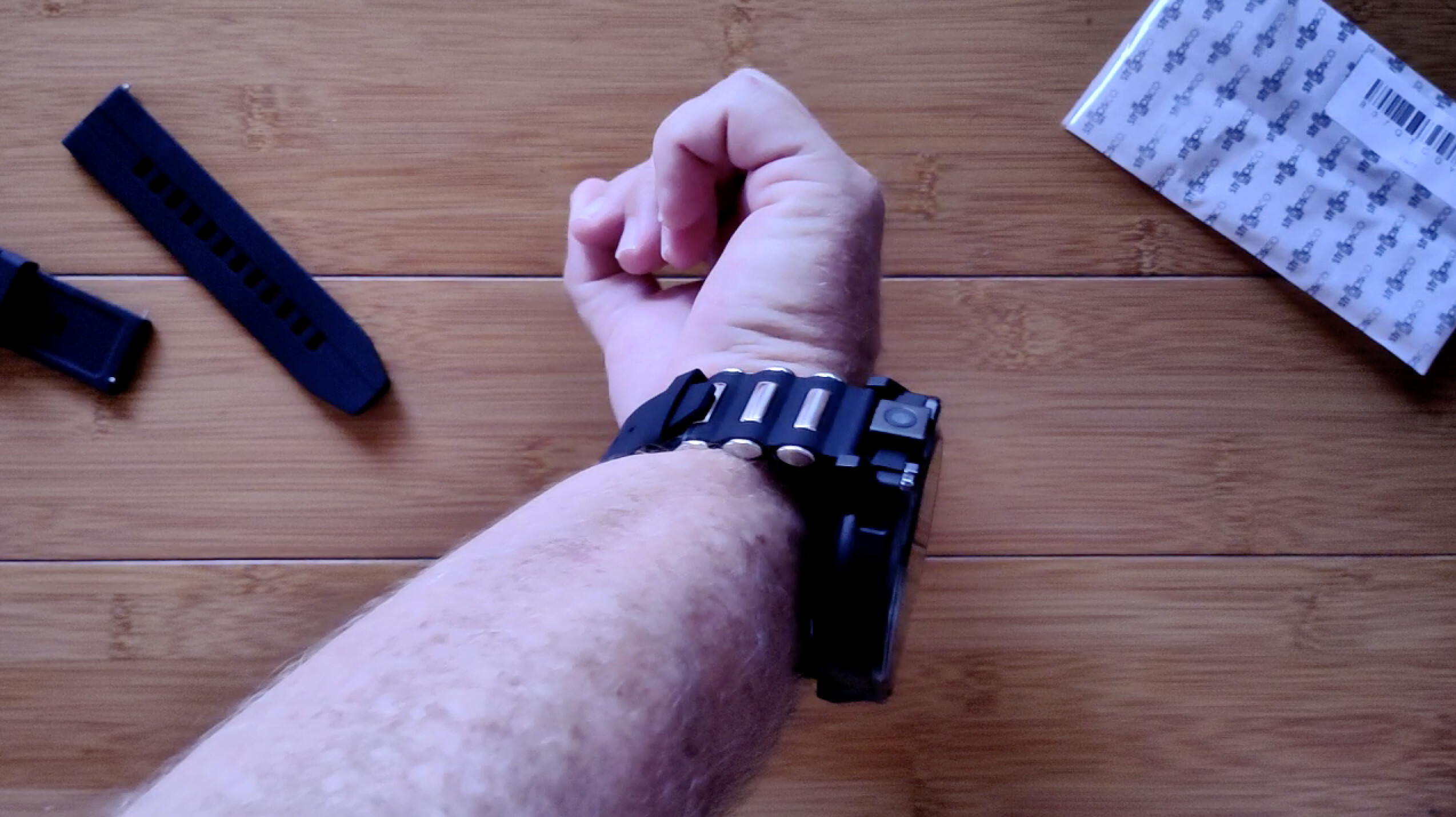

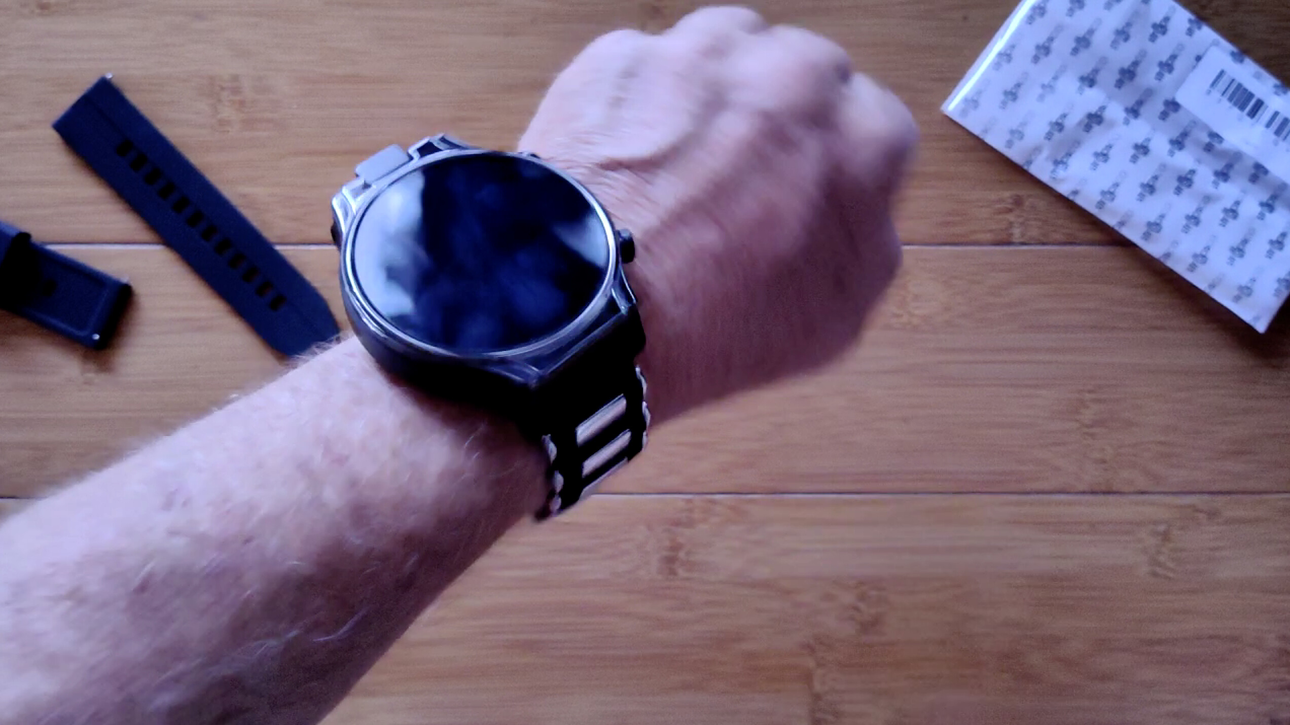

Just got in a bunch of bands to show off various watches in an upcoming video, and couldn’t wait to show you guys this one on the PRIME 2. For me it makes the BIG actually COOL!
