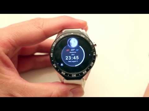

Just uploaded the first video I've made for a smartwatch.
Just uploaded the first video I’ve made for a smartwatch.
It shows the look and feel of my alternative launcher.
The software packages used are in the description.
I’ll make a howto video soon for those not so versed in installing Launchers.
There’s one glitch I noticed after uploading and reviewing the video.
Two of the clockface widgets are “stuck in time” Don’t know how this is, the other widgets of the same maker all work. The internal TSF widgets work perfect.
That’s why I believe, if there could be a good clockface widget generator, this is MY way to proceed with these watches.
The benefits of full access to a standard android launcher and it’s underlying platform, in this case a superb 3d launcher outweighs the limitations of the stock round launcher.
Only Android Wear with it’s playstore filled with apps and widgets beats this.

@Paul_Mackel I don’t own a Android 4.4 smartwatch but if the apps used support it I can’t see why not. The processor is a bit less powerfull which might impact the 3d animations.
Installing Twisted Home Switcher should enable you to use a different default lancher. It doesn’t break the old one. You can always return.

@Alessandro_Domingos The 3rd party clockwidges came from http://styleseven.com
But I’ve removed them at the moment. I noticed that either the clocks were 20-30 seconds behind or even stopped working. Sometimes they catched up, sometimes they didn’t. Also the seconds never showed. Good effort, but not flawless. maybe it works on Nova.
Let us know what Novaluancher does with the clockfaces.

@Alessandro_Domingos Thanks. Tried the clockwidget and it doesn’t work on TSF shell.
I cannot resize it and the minutehand doesn’t work. I have to test Novalauncher now.
Tested Novalauncher. Maybe it’s me using TSF Launcher for so long that I missed the extras and fancy 3d interface. It gives that extra depth to the watch. Luckely I made a backup before I uninstalled. Back with TSF again.
