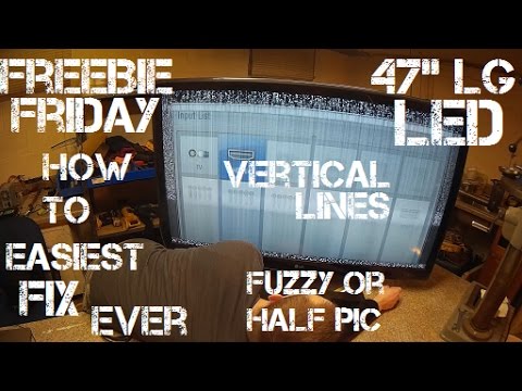

Something tell’s me that its not a hardware problem, because the interference only appears around the icons and text. If was a hardware issue i ģuess it would cover all the screen and not only around the images and text.
@SERZAO
Nope. It is a hardware issue. The pixels that are spuriously being turned “black” are the problem. The area that is displaying an icon or text is receiving data to turn on or off or different color and is masking the default black input.
I also get the same picture if the screen plug is not well connected. It does not necessarily have to be an irreparable defect.
Yes! Not a smartwatch display here, but you get the picture. Notice how the text and icons override the default background “static”.
