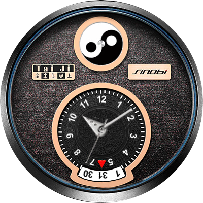

I have a “days of the month” array which shows through a window at the bottom of the skin. I select Invert Bottom to get the correct orientation of the numbers (not upside down), but when previewing, the orientation shifts back to upside down.

To be clear, in Design Mode with Preview Movements and Preview Fixed Data not selected, the numbers are right side up, when both Preview Movements and Preview Fixed Data are selected, they’re upside down. Same on watch???
you have to use ROTATION_WHOLE_TEXT_6_OCLOCK_NORMAL

Thanks again, Alexander… Yes ROTATION_WHOLE_TEXT_6_OCLOCK_NORMAL works, however the numbers - when changing from day to day - appear higher, then lower in the array (not following a perfectly circular layout. Michael aka Doubledad
