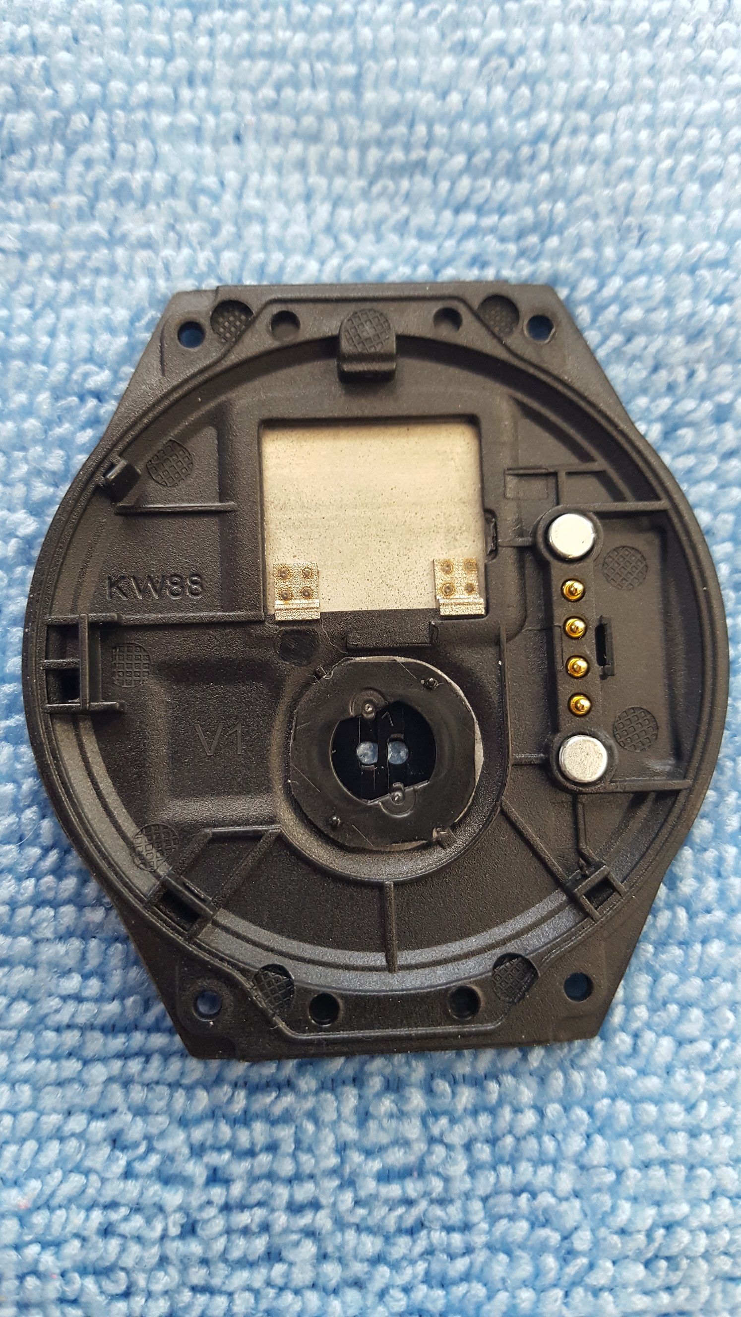

If someone has a new “revised” backplate for the KW88. Can you please make a picture of both sides for me. If it’s not too much trouble also with the sim door removed.
I’d like to compare what’s different with both backplates.
Currently I’m working on a hardware fix and I need to know if there are some differences.
Don’t know how I can tell its "revised"but my kw88 is brandnew and came with the newest firmware so here are my backplate sides
forgot to remove the door …already on my wrist ;-(
Need it ? then I’ll take another one later on
I’ve contacted Zoe, for a new backplate.
As I tried to compare yours with mine (couch) I noticed that two corner holes are cracked in two.
Comparing I couldn’t see any differences. Maybe if yours is newer they altered the thickness of material type. Or changed the Sim door so it closes better.
One thing I seem to notice is that yours has a black sim-door screw. If so, remove it and check if there’s a rubber O-ring under the screw.
Here there is a square rubber in place,doesn’t do much as it seems to barely touch the sim “door”( maybe just enough)
Thank you @Martin_Nijhuis for going the extra mile.
The only thing I can see different is the black screw. mine is like the other 4.
I’m going to try a mod where I seal thw sim door with epoxy. If it works the door is watersealed and you’ll be able to look into the watch/sim.
How often do you replace the sim anyways.
