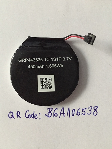

Hello, someone would know where I can buy the battery for my X5 Smartwatch, please ?, my watch does not charge, when I connect it the charging image appears, but nothing is charged at all
