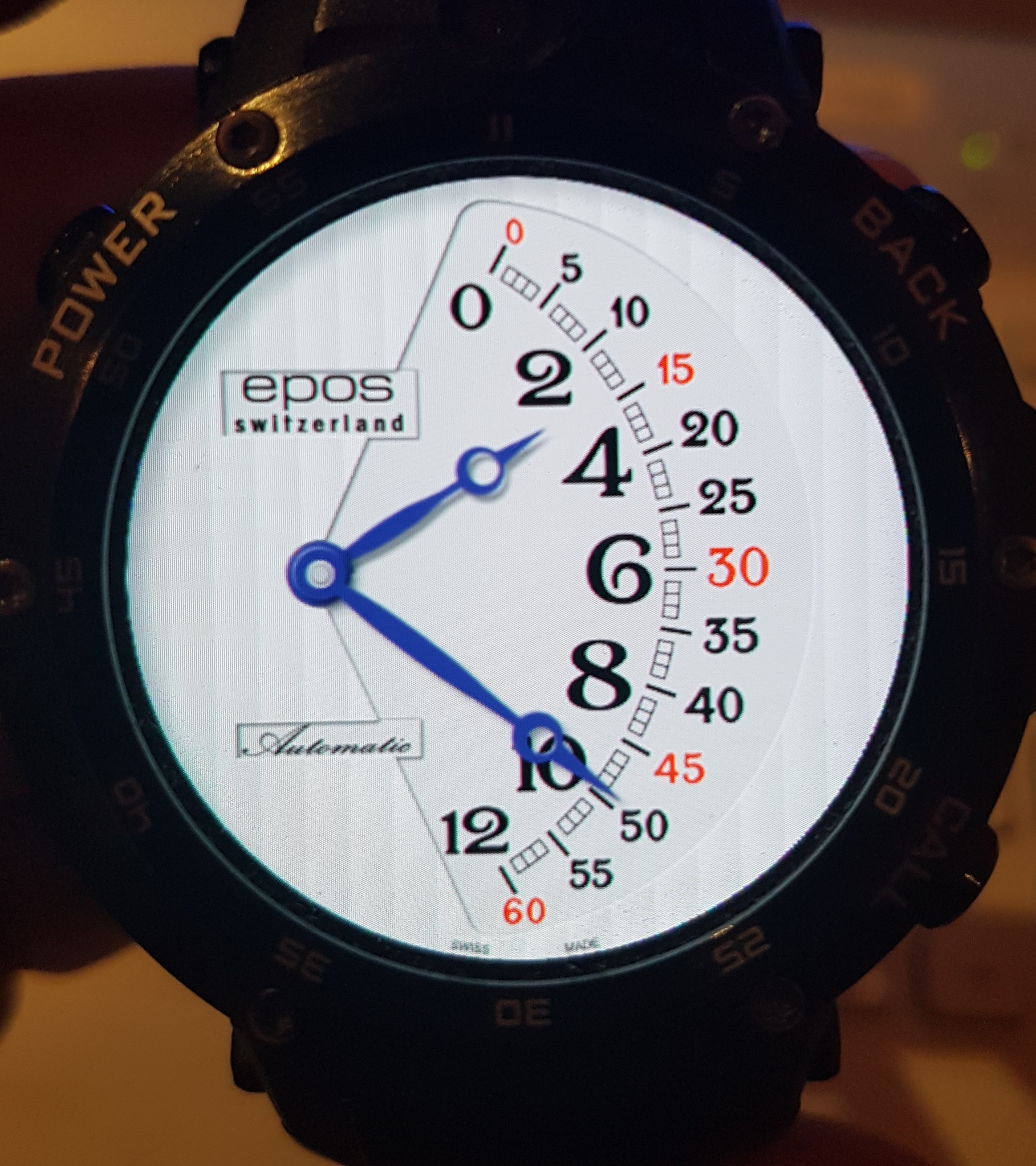

Here's an Epos retrograde automatic watch
Here’s an Epos retrograde automatic watch. I thought a long time how to realize it in clockskin format. Finaly I find a way, a big THANK YOU to @Eric_Crochemore . Needs Universal launcher, because it was necessary to use an animated GIF.

@Marco_Ferreira UPS, I was in a hurry, I will correct it tomorrow fixed. The Gif is the only workaround i found for a problem with mulrotate-3 that I have with this watchface. I used a 2nd hour hand and the gif is to cover the 2nd hand in the right moments. If you see a better way to make it work I would be glad if you can tell me.
