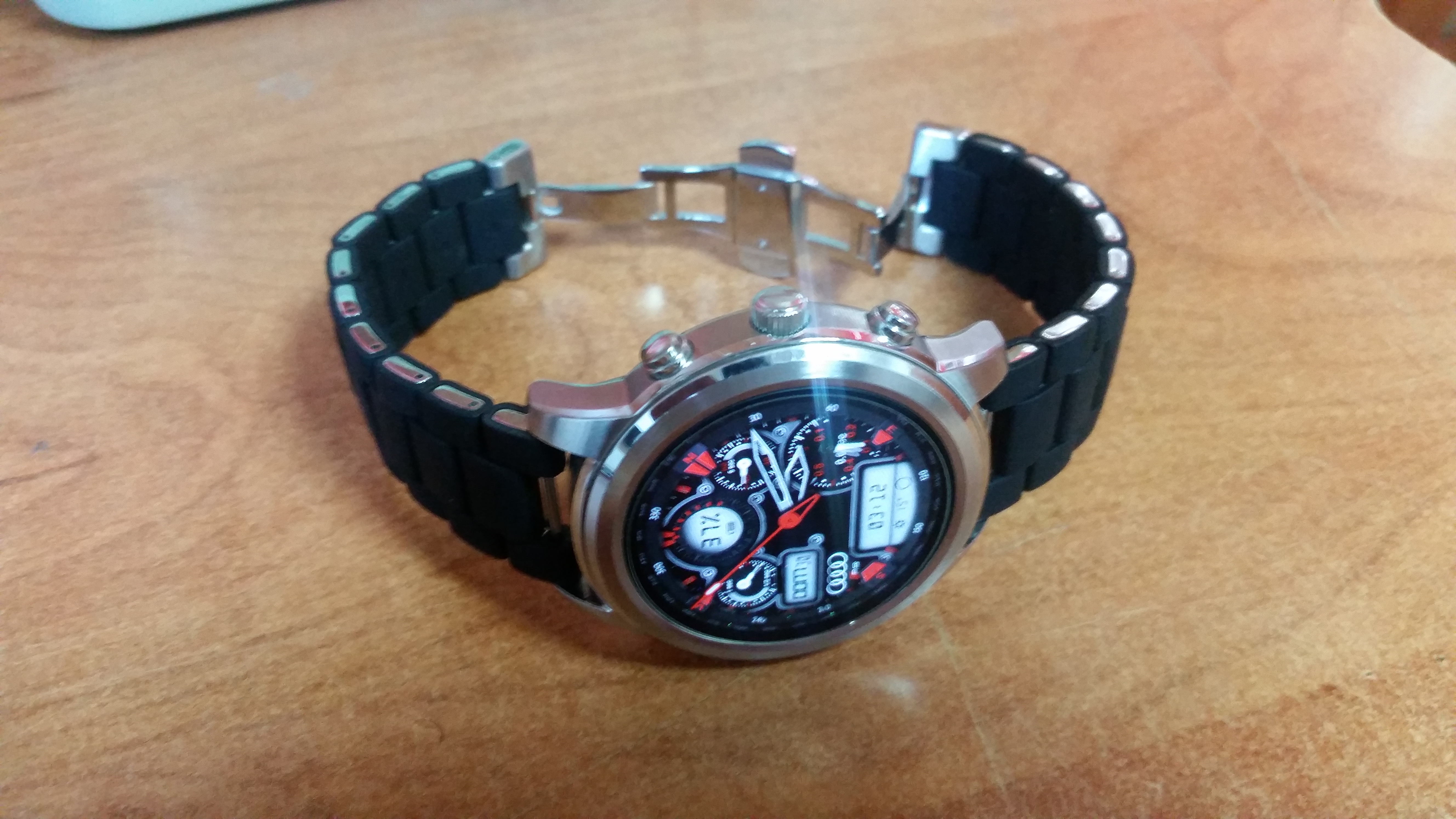

Here is my lemfo lem5 with new Silicone Cover Stainless Steel Watch band .
Cool, but How?!
Do you have all the process in photos? And the antenas?
@Rodrigo_Pina i remooved all antina rodrigo.
Ah :sweat_smile:
The GPS antena i understand, but the other(s) one(s)… Ok, great job (and balls) is it working normally? You still have Bluetooth, wifi and 3g working ok?
:+1::+1::clap::clap:
Blutooth is working but long distance its not works well. I dont like gps and gsm. Gsm and gps not working😊
Ameesh, Thank you for showing us this bold step !!! I admire your courage!! :+1::ok_hand::clap:
In the future I’ll do the same!!!
(I bought mine 1 week ago so it still my baby :laughing: and, yes, it’s a pity that we cannot change the band of your watch without cutting antennas… but…) Great Job Ameesh!!!
@Rodrigo_Pina -thank you.
wow nice job and thanks for showing us.
i have a request that could you please guide us step by step or else post pics. thanks
How many meters you lost the bluetooth connection ?
@Benjamin_Sisko - now i get 2mtr only😊.
Not bad ! It works fine with phone compagnion ?
@Benjamin_Sisko - some time it’s disconected. I am not using blutooth.
As long as people understand that this means GPS, WiFi and 3G connectivity are gone !!
Otherwise - in a few days time there will be many complaints that their watches are no longer working as expected…
How about WIFI? Is that still working?
@Mike_McManus - wiffi not working.
Ahh, bummer! :frowning:
Antenna transplant… :slight_smile: http://www.mforbes.ca/x5-smartwatch-antenna-transplant/
@zsolt_m
yes - but I do not recommend most users try this. It’s a very complex operation and many will end up with watches that cannot get a signal and have no warranty.
This was done a long time ago by other members - probably 12 months or so…
We never recommend it because the failure rate is very high indeed - be warned !!
