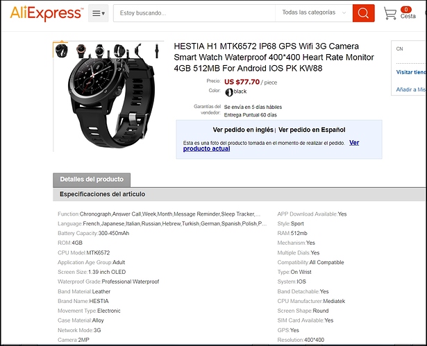

I am not sure if there is more than one version so I can only relate to the one I have. Bought recently it is running Android 4.4 operating system running the latest 08 08 2017 firmware that updated from the watch. While the listing said it has a 450ah battery but can have a 300-450 Ah battery, my charging voltage meter shows it is a 300mah in my watch. That said if I am only using it primarily as a watch I can get about two days out of a battery charge. I tried installing Eric’s launcher to be able to use better watch faces than those that come on the watch but did not have very good results, and not really needing it, I uninstalled it and went back to the standard launcher.
It has many very useful stock functions as you may know if you have researched on the internet. The one problem I’ve had is the zoom feature that allows you to view for example the whole page of a web site does not function. It is stuck in the zoom mode, which is probably better than the other way. I tried doing a factory reset but it did not change the ability to adjust the setting. I did have some effect on the watchfaces using Eric’s launcher. The zoom function in the launcher would not work either because the basic function in the watch was inoperative. I bought the watch primarily for its waterproof rating. I live on a boat and I always try to have water resistant phones and watches when I am operating the boat. If not you will be replacing them often. I have not tested the water resistance of the watch yet but based on the tests I’ve seen feel confident it will meet my needs.
So the fact that these other features are not available to me is not important since I do not plan on using this watch as a full time smartwatch. I do like the watch for its many useful features and applications, however I much prefer my KW08 tethering watch or the Thor for use as a smartwatch.
