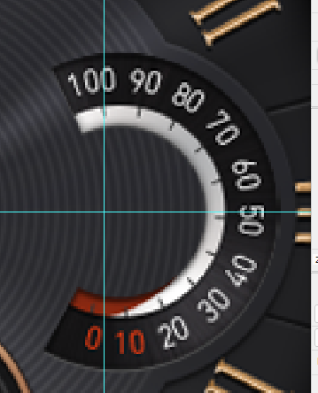

I have permission to post this watch face. Anyone have permission to change watch face and solve this problem. Does anyone want to solve the battery level problem?
On my Finow X3 when the battery full is on battery level shows 90%. Then it shows 10% less. Thanks.

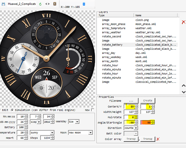

Try use this settings:
Thanks zsolt m. The problem is partially solved. From 100% to 50% shows good after +2%.
You need rework those images. The battery rows, indicators. Yet not centered.
Try this and upload as yours.
https://drive.google.com/file/d/1HprB70chnURtfsDLYftFJThNvc4GssU-/view?usp=sharing

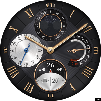

battery is not the only problem but the moon phase. mine shows wrong moonphase data
@Daniel_Herrero It’s known bug. The clockskin engine itself cannot reproduce the correct moonphase. Not a skin issue.
great job! worked fine on LEMFO LEM5 PRO.
