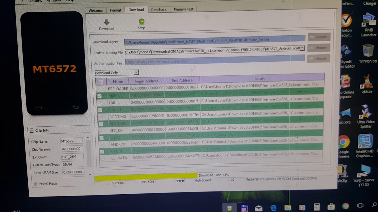

The last thing you can try is flashing the firmware
If this doesnt work and is a hardware issue you will need to contact jason .
@Dr_Andy_Vishnu is right. Flashing the Firmware is the last option. If it doesn’t work, you have to talk to Jason.
Do I do this on the watch or pc?
Hi . Make sure watch is fully charged and turned off . You flash your watch while connected to pc ( not Mac )
This might be anove me afraid would screw it up.
It’s not so hard. Follow the video step by step. We will lead you if have any problems.
