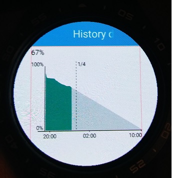

Eric I tested 1.1.3 today and it is actually fantastic with battery usage. Fantastic job. I am looking forward for notification changes at the launcher.
Power drain
KW88, Launcher 1.1.3
I have noticed that switching on wrist gesture activity (in the launcher) starts drain the battery
also when watch lay down without any movement
like movement watchdog is keeping processor too busy
power drain is 2-3 times higher compared to identical situation when gesture is off

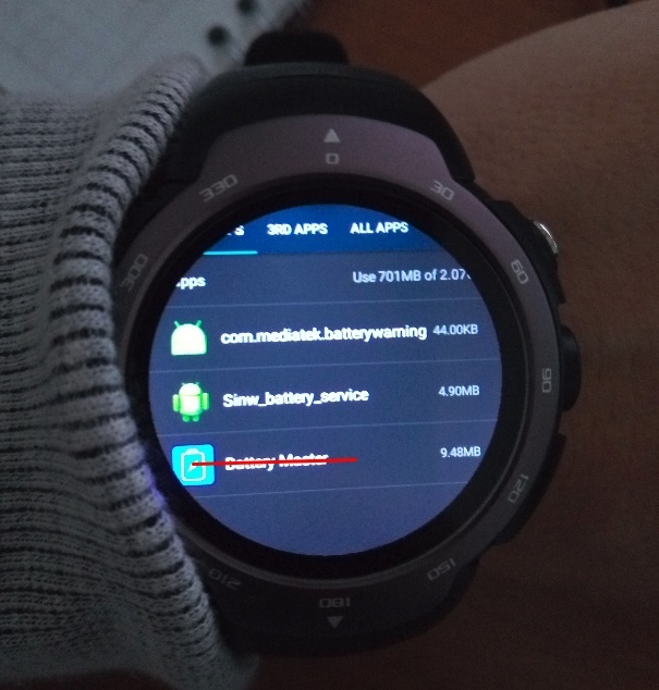

UPD4:
Power save system app (Battery Master) was freezed by Root Uninstaller. I have great background app BlipBlip (beep sound every hour) and it works in background without any problems.
