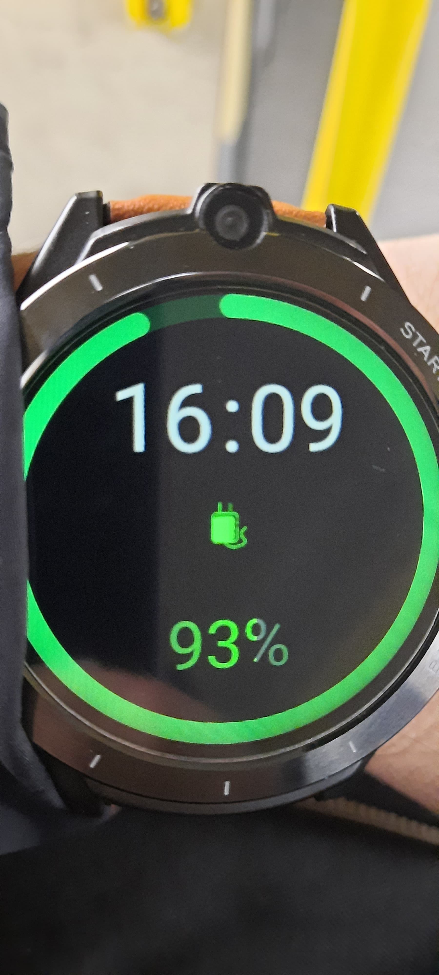

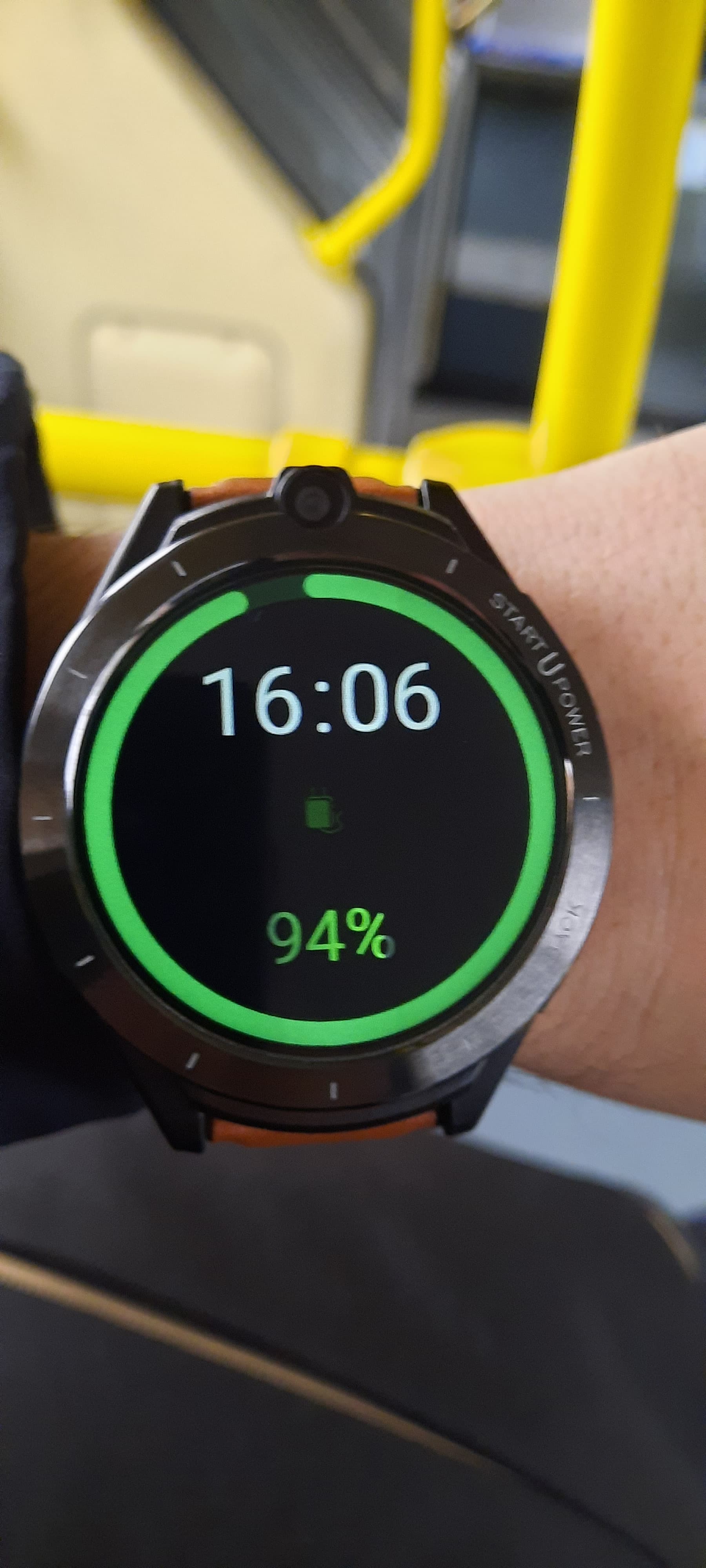

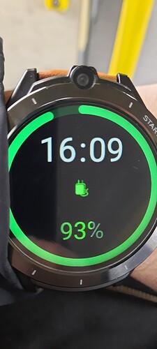

I left the watch on charge, after auto-locking the screen, I check by pressing the power button how many hours are charged, the clock is 100%, I remove it from charging. Further, instead of the dial, the watch continues to charge, the charge display function hangs, only as you move the curtain to the side, only rebooting the device helps. pointed to the excel, face recognition.
I had the same problem some times ago, but for me not a big issue, because after a restart everything is OK. May be, this was my explanation, the watch was not charged exactly to 100 %,…, but I had this issue never again.
This is the price to pay for these custom apps that go against the stock Android security and permissions.
Face Unlock is no longer supported and so it can cause issues.
The “eye candy” charging animation is using the screen saver and lock screen functionality, and so it too can cause issues if you use a secure lock screen, like a pin number.
These issues are known, but because so many people think they are “wonderful features” - they are not removed.
Almost everything in “Optimisation” section is a nightmare for Android OS.
I suspect that the various permissions issues that have been reported are also caused by these kind of functions and customised apps.
