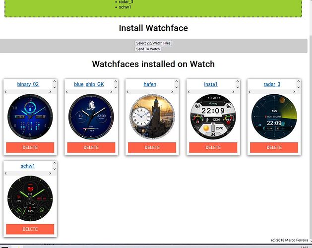

On the other hand, I had no problem copying and pasting the watch faces from my pc to the clockskin folder.
Version of my watch: EN_V1.1_20220707
Installed the SPD driver on my PC ( as Administrator ), restart the PC and the LEM16.
Result : the same procedure as before, not possible to drag and drop
clockskin transfer : thank you so much for this fantastic tool. Much more easier than to do it with drag and drop.
I had no problem with it, it runs !!

First experiences with my own watchfaces: they all were OK on my Genesis, but after copy them to my Lem16 there is much re-work to do.
Battery symbols must be moved to the left.
Touchpoints probably have other parameters now (e.g. weather).
I have also noticed that the lift to wake function works much more slowly or not at all with my own watchfaces.
