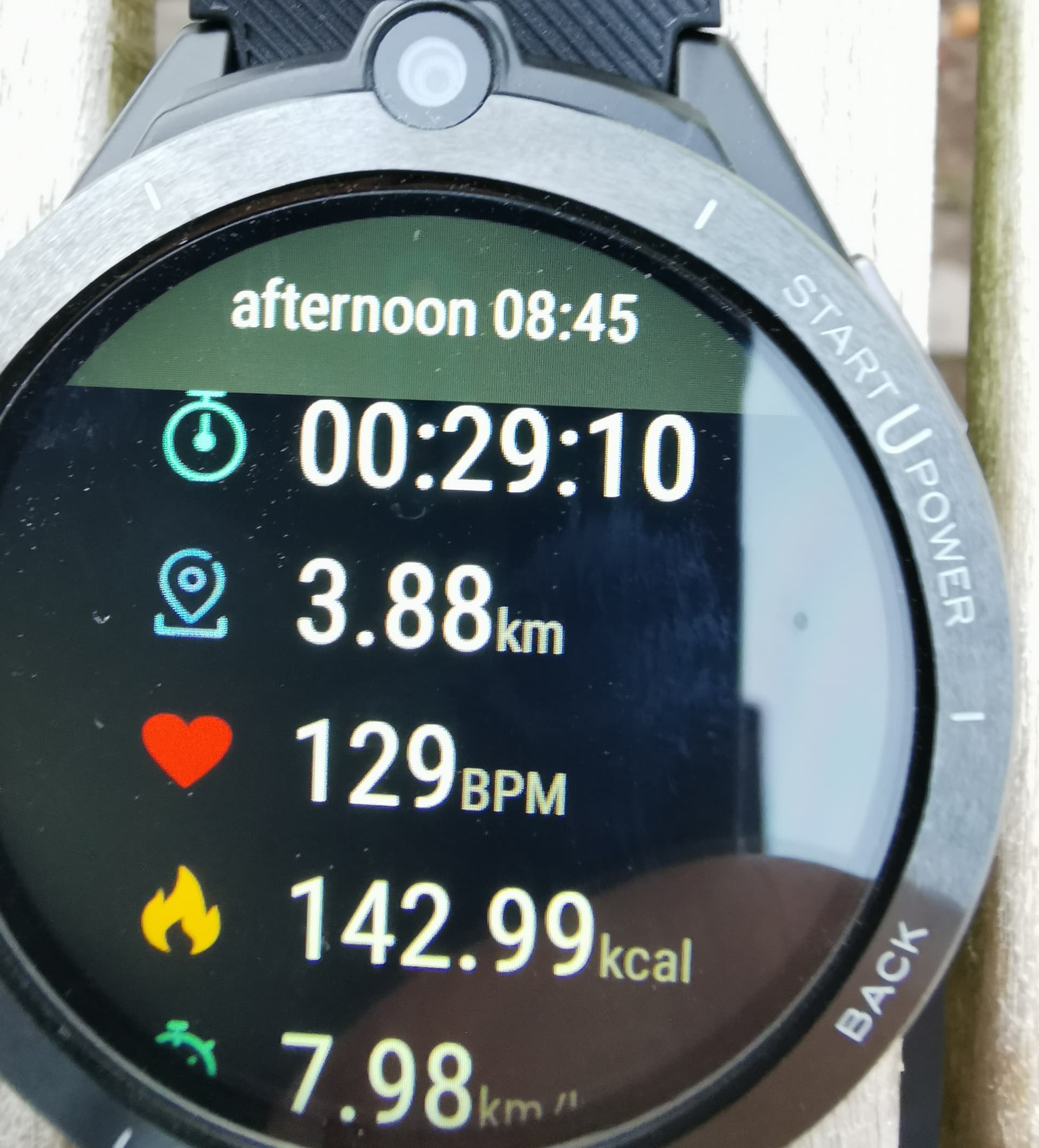

Enjoying the watch. Build-in Fitness app is ok. Took a small mountain bike ride this evening. It also has a historical track on the map of the ride.
One small detail, time should say 20:47, but uses 12h format even though watch is setup to 24h.
