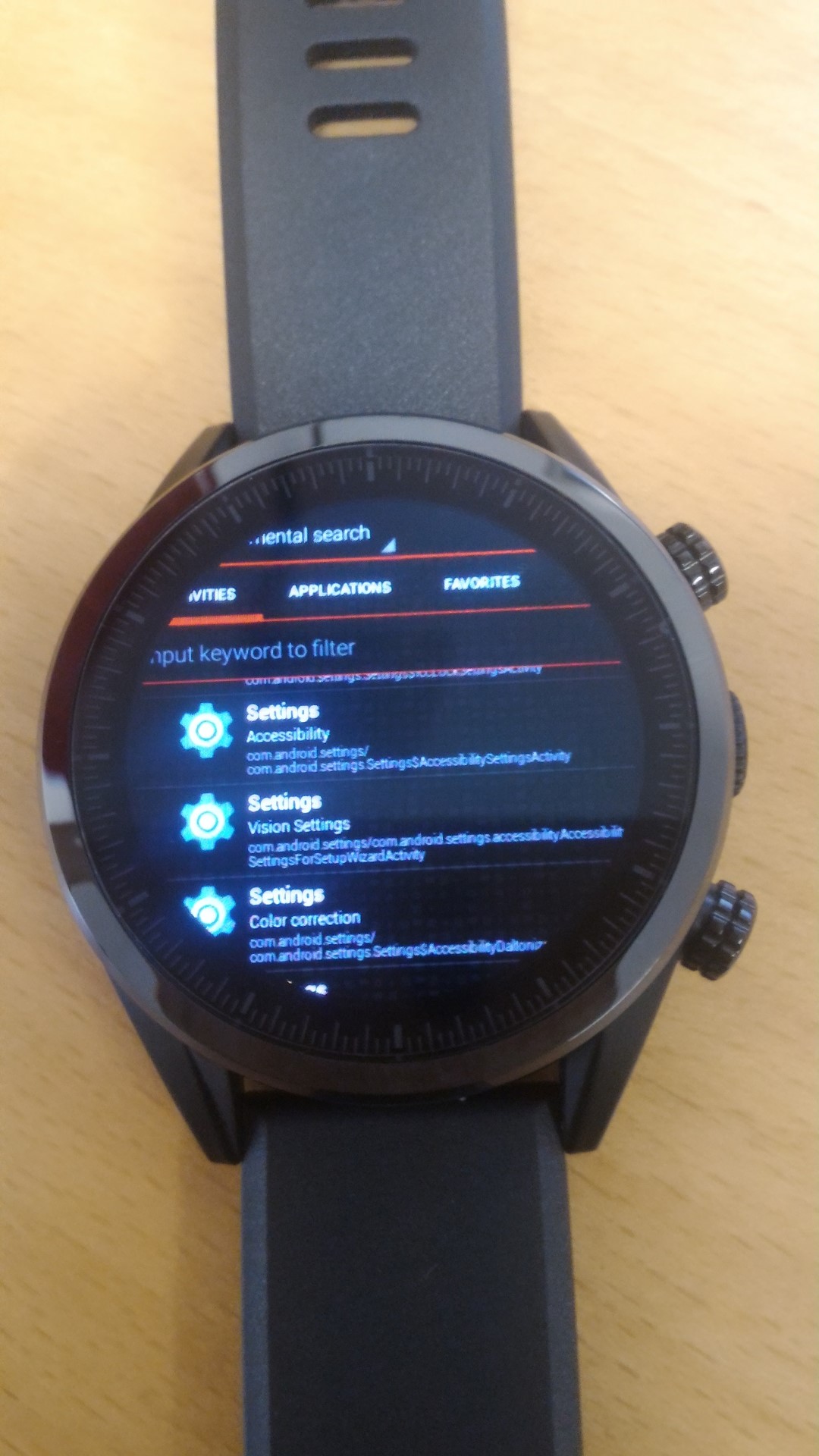

I installed QuickShortcutMaker and can now select all Talkback settings and also enter the “missing” Accessibility settings menu. Here are the steps to change the Talkback settings:
  1. open QuickShortcutMaker
  2. in the Activities list (opened by default) scroll to “Android Accessibility Suite” and tap it to expand underlying items
  3. tap for example on the first Talkback settings item and in next screen tap on “Try”
  4. the Talkback settings screen opens and you can change any of them
  5. when you are done press the back button twice to return to QuickShortcutMaker activity list and repeat steps 2-4 for any of the other Talkback and Accessibility setting screens

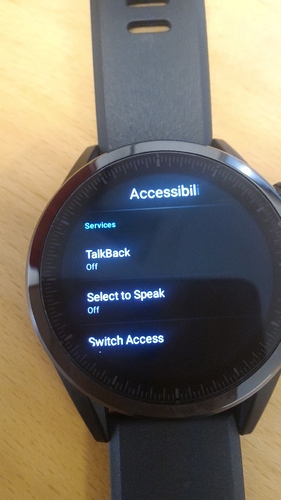

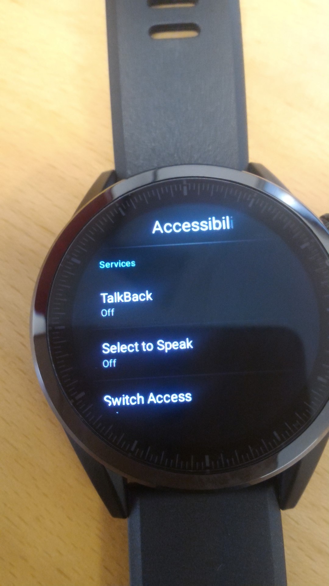

And here are the steps to enter the “missing” Accessibility settings menu:
  2. in the Activities list (opened by default) scroll down to Settings and tap on it
  3. Scroll down to “Settings Accessibility” and tap on it
  4. In the next screen tap on “Try”
  5. The Accessibility settings menu appears and you can enable/disable Talkback
I have no experience with Talkback and hope this helps you to get it to work.
I just tested it and Talkback works flawlessly
Hi and thank you for taking the time. This fixed the issue, and TalkBack is working now. I am able to use the Watch.
