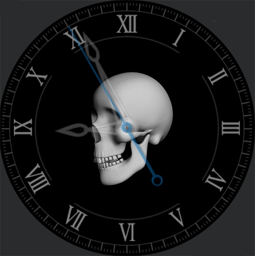

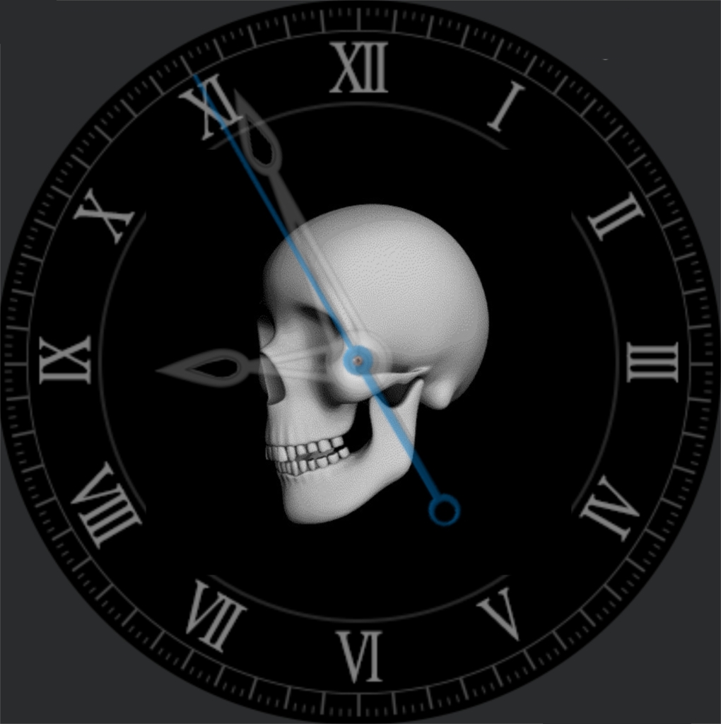

Here’s my first attempt at adding animation to watch faces and it works well with Rick’s launcher.  It’s minimalist in nature with just roman numerals, semi-transparent hands and a rotating 3D skull.  The skull began as an animated GIF that I converted into 72 separate jpeg frames to obtain smooth motion.   You can get a copy of the face here:  AnimatedSkull
Feel free to plagiarize this if you want.  I obtained all the graphics off the web and created this face as a learning exercise so there’s nothing copyrighted or proprietary.

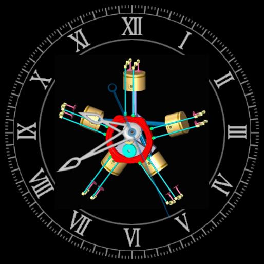

Here’s my second attempt with animated watch faces.  This watch has a 3D radial engine running the mechanism.  The file size is rather large in order to provide a smooth frame rate.  This also runs quite well on my Finow X5+ and RickTop’s launcher.  Get it here:  3D Radial Engine

Jan 28, 2018 5:54:38 GMT 1 stevef said:
Here's my first attempt at adding animation to watch faces and it works well with Rick's launcher.  It's minimalist in nature with just roman numerals, semi-transparent hands and a rotating 3D skull.  The skull began as an animated GIF that I converted into 72 separate jpeg frames to obtain smooth motion.   You can get a copy of the face here:  AnimatedSkull Feel free to plagiarize this if you want.  I obtained all the graphics off the web and created this face as a learning exercise so there's nothing copyrighted or proprietary.
I don't know which tool, if any, you used to split the GIF into separate images. If you use WatchFace Designer to create the watch and place a GIF in there, it will automatically convert it to separate (PNG) images. It can also export to ClockSkin and WatchMaker format. If you don't want to use WFD to design your watches, at least the 2 steps of "put a gif, export watchface" will give you the splitted gif with almost no effort

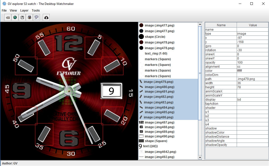

I prefer to design my watch faces on the PC using the Desktop Watchmaker rather than being confined to a small Android device.  You can get Desktop Watchmaker here for free:  Desktop Watchmaker
Splitting the animated GIF files is also not a problem.  I use IrfanView to split GIF’s for my projects but there are also several online web services that split the GIF’s for free.

Great. WatchFace Designer is also a desktop tool, by the way. But it’s completely different from Desktop Watchmaker and is more focused on clockskin than watchmaker. And you should, of course, use the best tools for you. So keep up the good work
