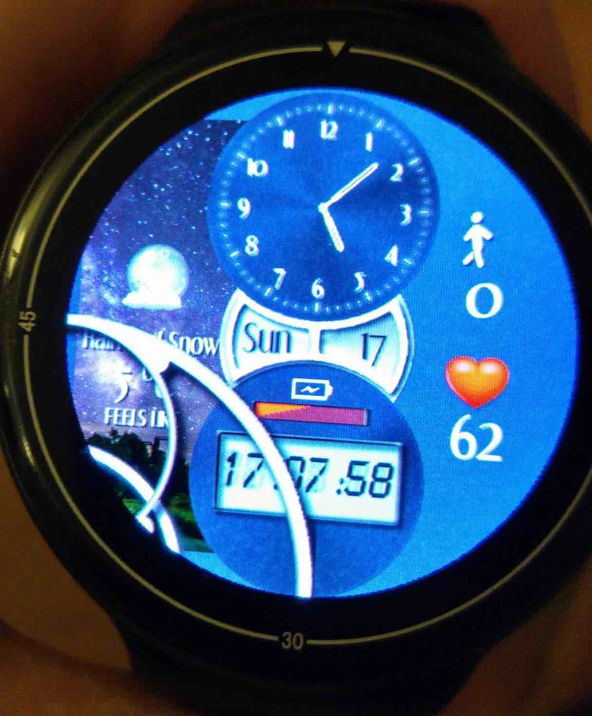

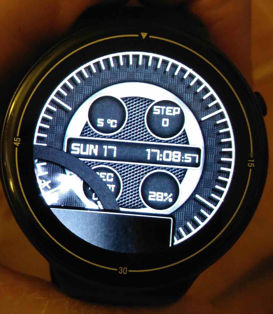

All of sudden all my best skins become corrupted. Reinstalling and even downgrading till 2.3.5 does not help. What might be the problem and how to cure it?

Looks like you didn't read my post on previous page.
OK, you’re right. Now i know why this s…t happened, but still don’t know how to fix it. please advice

You can’t fix it, just use another face until i publish the fix.
Thank You, will wait then. Good luck in fixing it!

2.4.7 published. It solves the issue.
