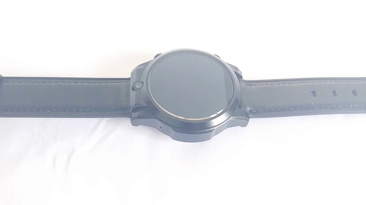

Janus 4G Dual
This is the exact same watch as the Thor 4 Pro and x360. Some have dual camera and some don’t. Some have 1gb /16gb and some have 3gb /32gb. All have the same main board and screen.
X360: https://bit.ly/2I4GShC
It has a slightly bigger screen but with a flat tyre area at the bottom.
It is a nice watch and is made by the same solution provider that makes the Optimus Pro, Thor 5 and the LEM9 and KW88 and LEMX, in fact all the watches apart from the Kospet Brave which runs FunOS.
If this is interesting for you and you don’t want a dual chip solution, then you may be better off waiting a little bit longer. There are new models coming up soon.
